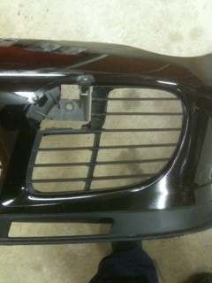

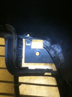

Dec 5, 2010 | 06:32 PM
Here are a three pictures of my old bumper cover with a bumperette removed.
First shows the slot and 2 holes drilled to fit the bumperette retainer screws.
Second picture I have a new (untouched) grill laying on top of the bumper just to see whats covered and whats not.
Third is from the back side showing the 3 slots that they make to melt the bumperette retainer into that will have to be removed.
Each side will have 5 holes and the large slot above the grill that I would think needs to be repaired? The grills shown above wont be enough.
Reply
