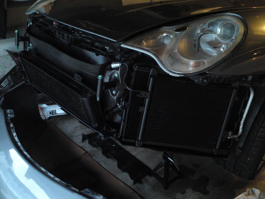

That is not the entire truth. The bumper itself is a skin only. What you do inside of it is you choice. Some do functional conversion, some don't. Titan Motorsports have a great writeup for functional GT2 front conversion here. Using the info from that writeup I did 2 functional GT2 front conversions so far on 2 different 996TT, using Precision Porsche front bumper, GT2 radiator "inclined" position, OEM GT2 air ducting.
It helps downforce on track from 60mph and up and the faster you go the bigger the difference. 996TT build a pretty noticable air cushion under the front where as the GT2 duct in allows a big part of the air through the center radiator to go out above the hood.
A pic for illustration. On the ground the GT2 front from Precision.

I stand by what I said, if you want gt2 functionality you need to use factory parts. I know you can install a replica bumper over the updated parts, my point was that to do the conversion correctly you need the updated radiator bracket (or bend yours after flipping over), air ducting, fender liner vents, etc. Even without the bumper parts cost alone are over 4k. If you want to cheap out on a bumper after spending that much by not going OEM thats fine.
@ Addington; not intentional to come off brash, I just wanted to avoid OP to give up his hopes of a 100% functional replica GT2 front conversion within reasonable $$. Also want to support our board sponsors who make some pretty awesome products for all of us who want to maintain a reasonable budget on certain items, like this one.
@ OP, a few details about the installation;
The PP front has a fairly long flat bottom that extends to overlap with the TT fender lining. So you can keep the TT liners with full aero "tightness". Unless you go with OEM bumper which is shorter underneath, then you have to tack on the price for those liners.
The center radiator flip and using a couple of tabs puts the center radiator in the exact GT2 position to match the rear and front ducts, so that saves a grand or smth in that range compared to GT2 brackets. It also saves a lot of work, since you otherwise have to remove the side radiator/fan assemblies and get in and swap the brackets. You don't need those parts from a GT2 to be functional as the only thing they do it hold radiators, no magic there. The difference between the two sets of parts, is that the GT2 brackets have two little ears sticking out at an angle. The function of those ears can be attained by slightly bending the TT brackets then bolting a couple of small "tabs" to the TT frames. The price factor is 3-5 times the price of the TT parts due to GT2 being a very limited series car, that's why a complete GT2 parts list as Addington describes becomes so hugely expensive. However important fact: you will still have aerodynamics like a GT2 retaining the TT parts described in the Titan mod (link below).
The top vent and lip (both OEM) you'd have to get those for OEM bumper so no difference. Front air ducts and trim pieces will be GT2 all the way or will look totally tacky. They are pretty expensive.
All in all doing it like this won't cost a fortune and it will for sure give you GT2 aero function where the center radiator outlet goes up top over the car, the underside of the car is sealed tight to linings and underfloor panels, and cooling will be just as good as before the mod
