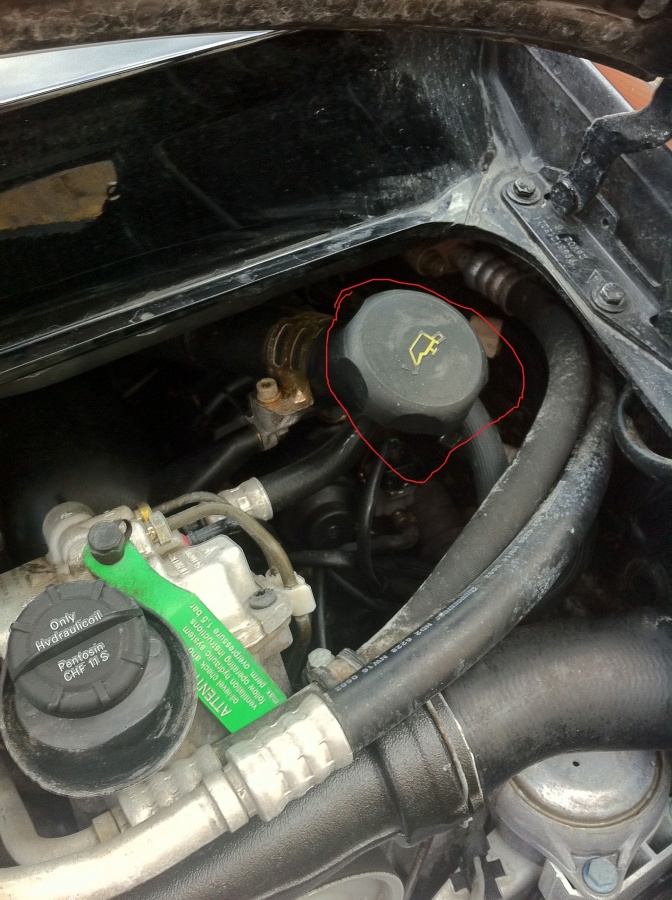

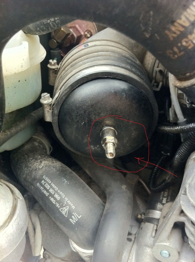

Hello I have a problem high idle. Durametric show me P0174 error code. I know what its mean. that's what I did 1. cleaned the MAF 2. сleaned the throttle 3. checked the vacuum in the inlet oil (no all ok) 4. check the intake for leaks (use compressor) a little leak is in oil under the cover of the neck, If you remove the cover a huge leak, so it should be? I took a few photos that would have been more clear, please be advised that you can still try to check

It is normal to get air out of the oil filler cap. I've tried to use the starter to crank the engine to get the intake valves to be all closed but was unable.... I always had a little bit of air coming to the oil filler cap....So far you did well to found your problem. You must have a leak somewhere especially in the multiple sense lines on top of the engine....

You have to do a pressure test from the turbos... same idea ... but you block one off and pressure the other.... try to get 15 to 20 psi... Im guessing its a vacuum leak... a bunch of lines run in back left side of TB....
