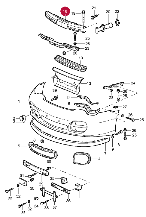

Have been doing homework on the gt2 radiator conversion, studying various posts over years on this subject. Big thanks to contributors. Few questions.
I believe the 2 part numbers in red above refer to the side radiators rather than side brackets. Does anyone have the part numbers for these (middle of ducting in pic below)?

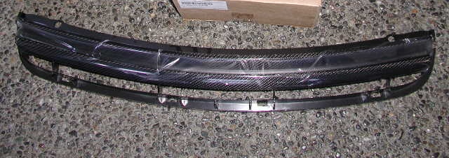

Bumper center radiator grill (part #10):
Which manufacturer(s) offer a grill that fits same as OEM (CF, PU, or FRP)?
Is the grill fixed to the Center Rear Radiator outlet duct (part #13) or the bumper?
Attached an exploded diagram: upper/lower radiator brackets (parts #'s 2&3):
RADIATOR TOP BRACKET 996504 195 30 - $409
RADIATOR LOWER BRACKET 996 504 413 30 - $255
Anyone tried modifying the TT ones? The OEM gt2 ones are pricey, 2-3xs the price of TT counterparts.
Thanks in advance!

The center grill mounts to the bumper and provides additional structural strength to that area of the bumper.

I actually removed those pieces (#18 in red) from my bumper support because of interference. In the process of helping sell the kit I've been holding onto for about 2 years now, so I'm going back and re-reading what I did... Did I mention I miss my 996TT more than any other car I have ever owned???
Mike
