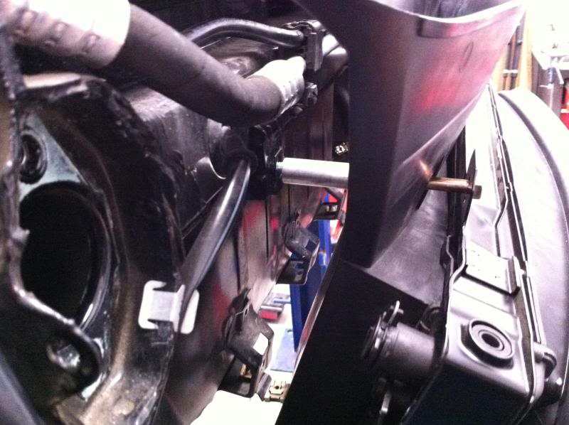

I installed the GT2 ducts recently and used this post as a reference.
I wanted to point out something I noticed which is inccorrect on the guide and caused me some headache when doing the installation.
First things is that the radiator spacers are installed incorrectly on the thread. If you would tighten up them like this, you would bend the radiator bracket. Also the spacing would be incorrect on the radiator. The correct way to install is the long section of the spacer will be installed torwards the radiator bracket and the short one behind the duct.
Incorrect orientation found on this thread:
Correct placement I made:

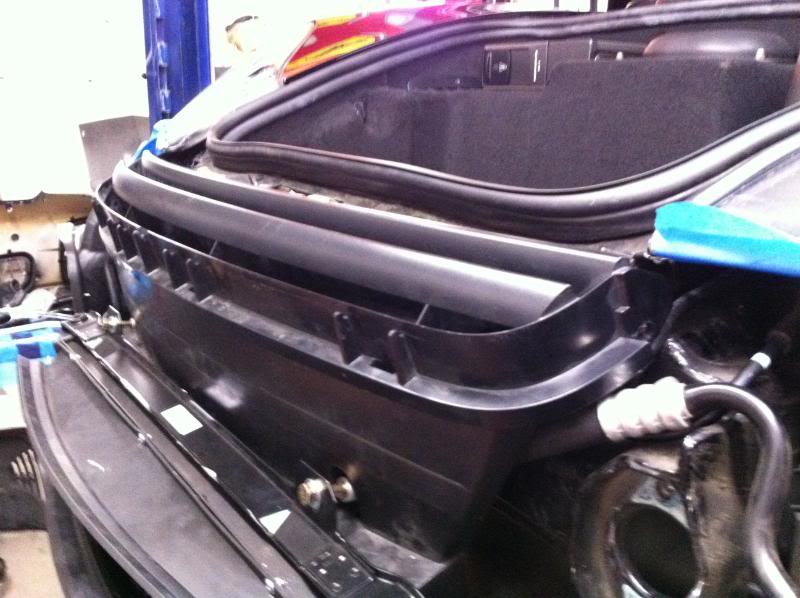

Other correction I noticed
The center duct is installed the wrong way around even though the thread says "Proper oriented center duct". I installed it looking by the below picture and was wondering why the bumper wouldnt fit in place. On the other pictures on this thread the center duct seems to oriented correctly.
Incorrect found on this thread:
Correct orientation found on this thread (you can see its different, here the duct is level with the radiator)
