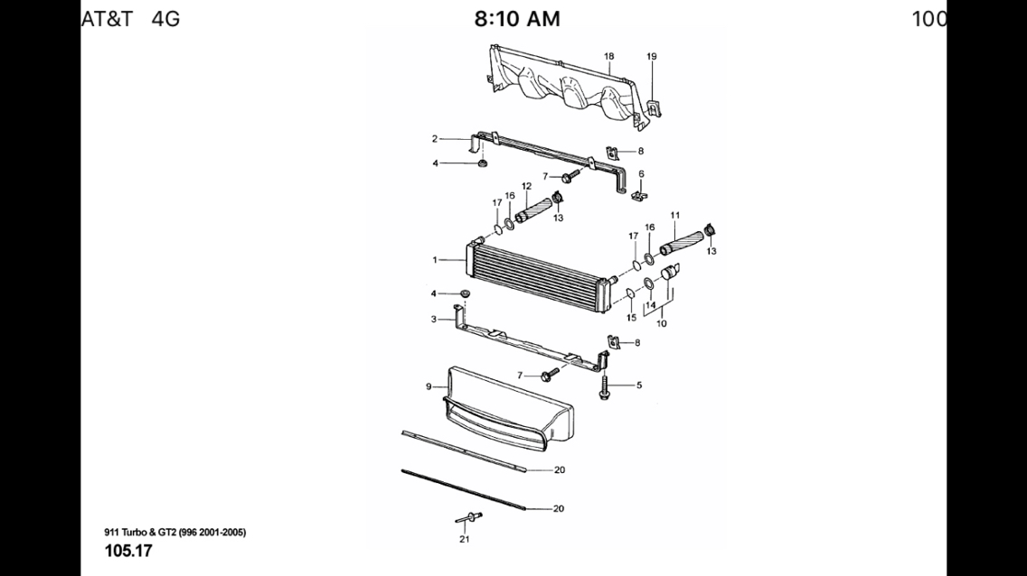

This is correct. The 996tt hoses are on the top which will get in the way when you try to install a factory GT2 upward facing outlet duct. Here is a diagram showing the 996tt radiator hose orientation. As long as your hoses are on the bottom you should be good.

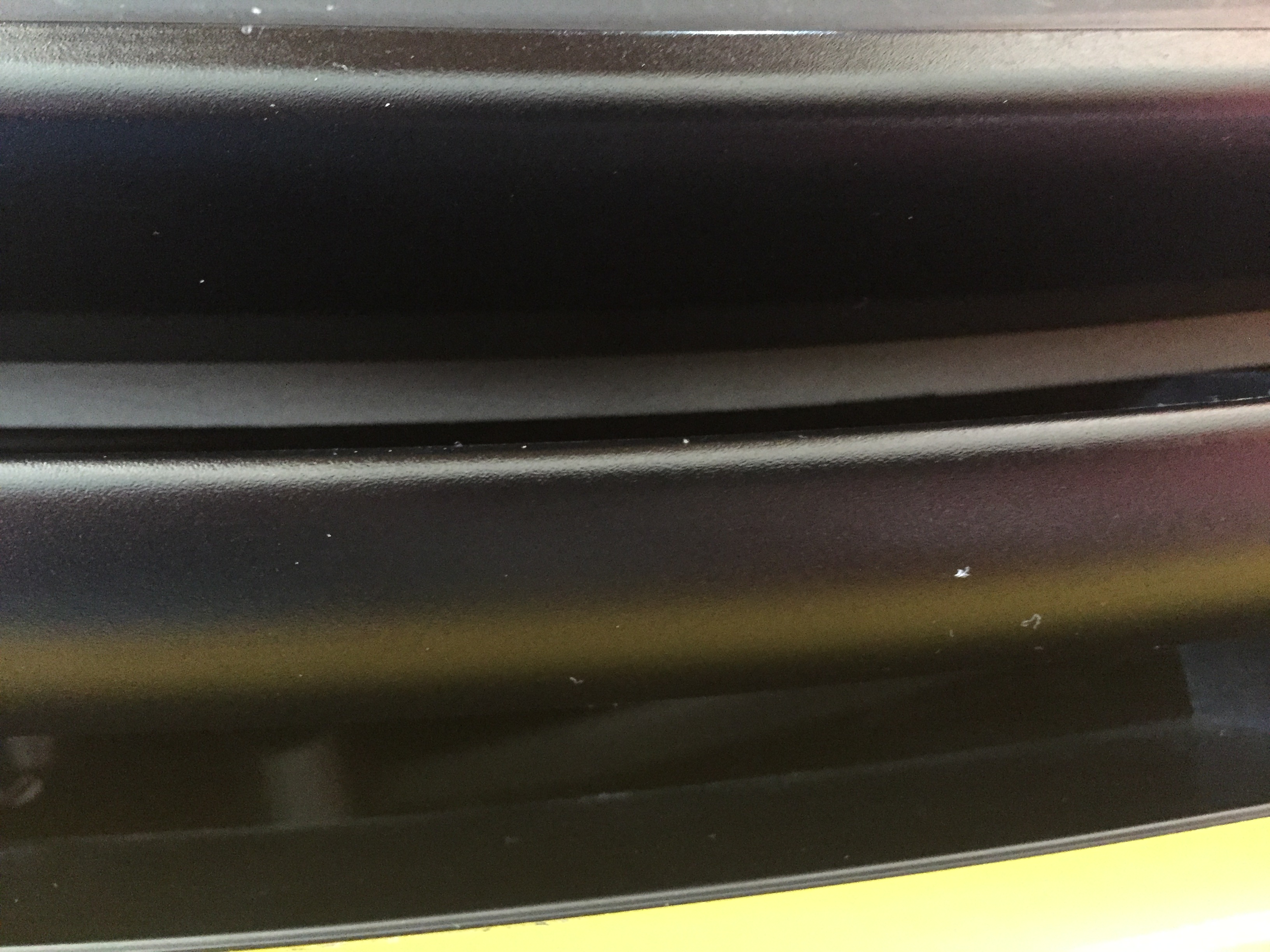

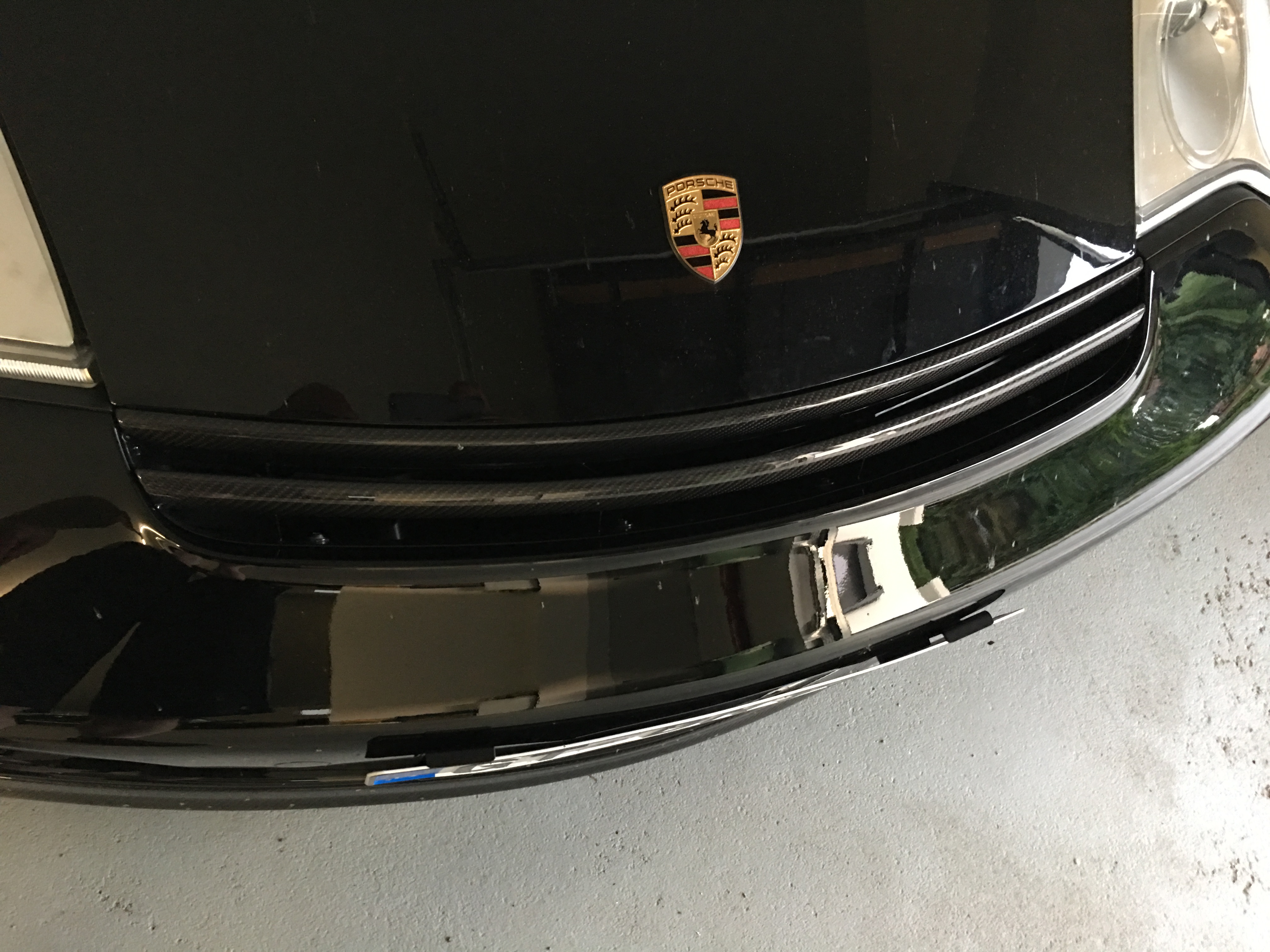

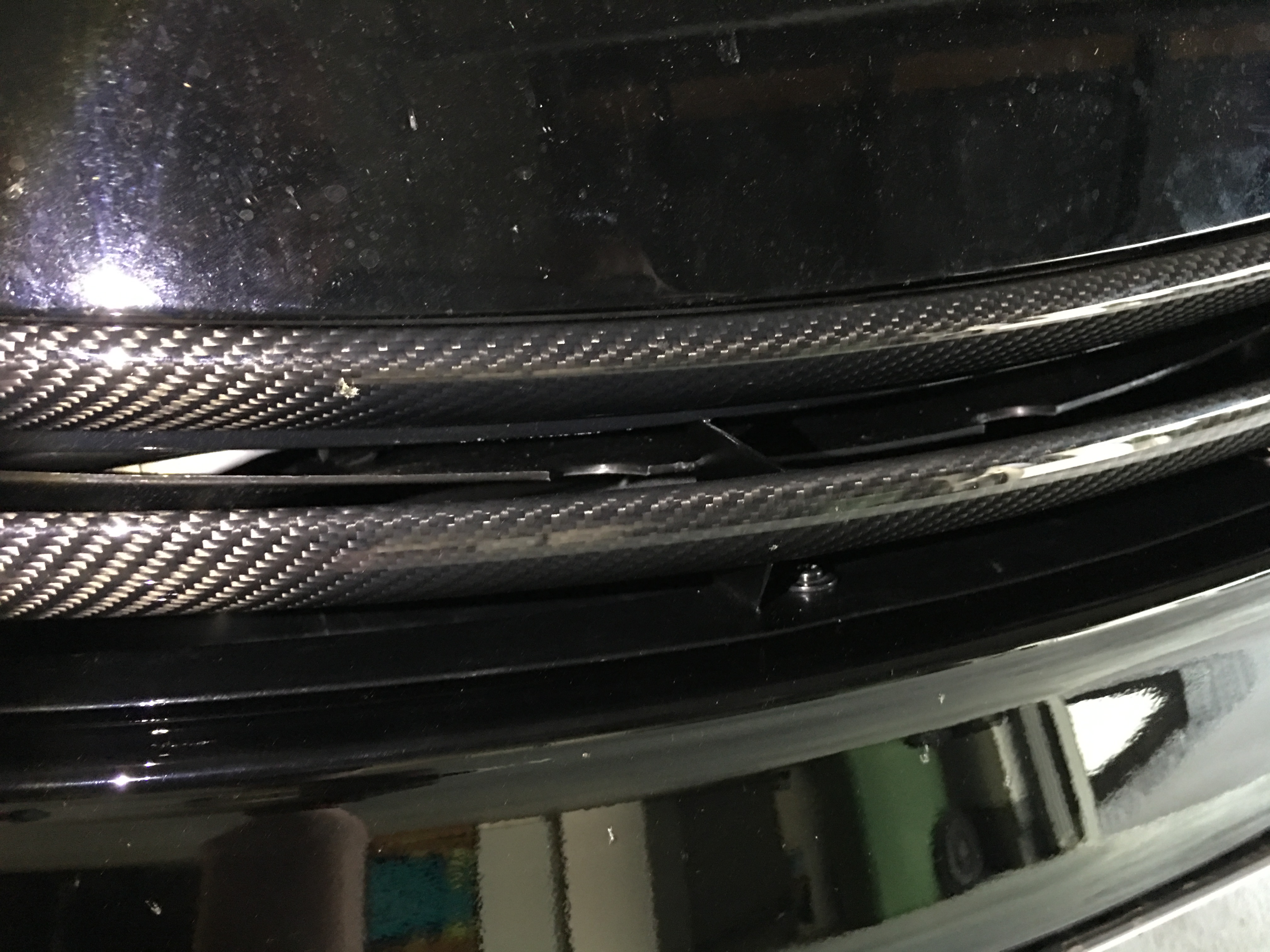

Another questions regarding the Center Air Outlet, is this misalignment from Center Air Duct to Center Air Outlet grill normal? During Installaation everything was matching and looking nice, maybe somebody has some Pictures, couldn't find anything in the web

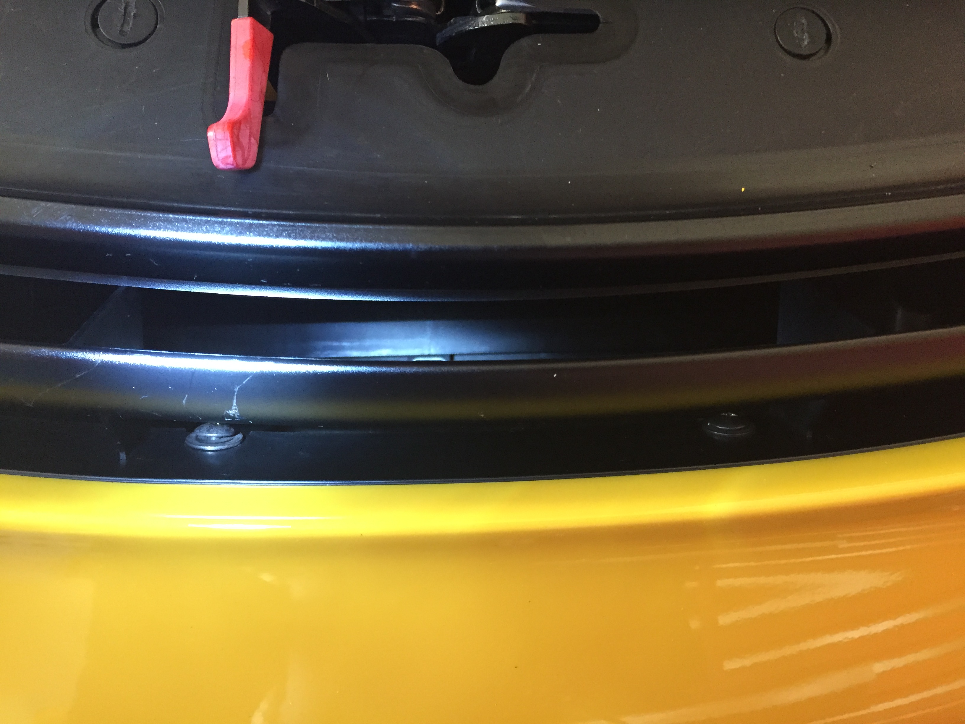

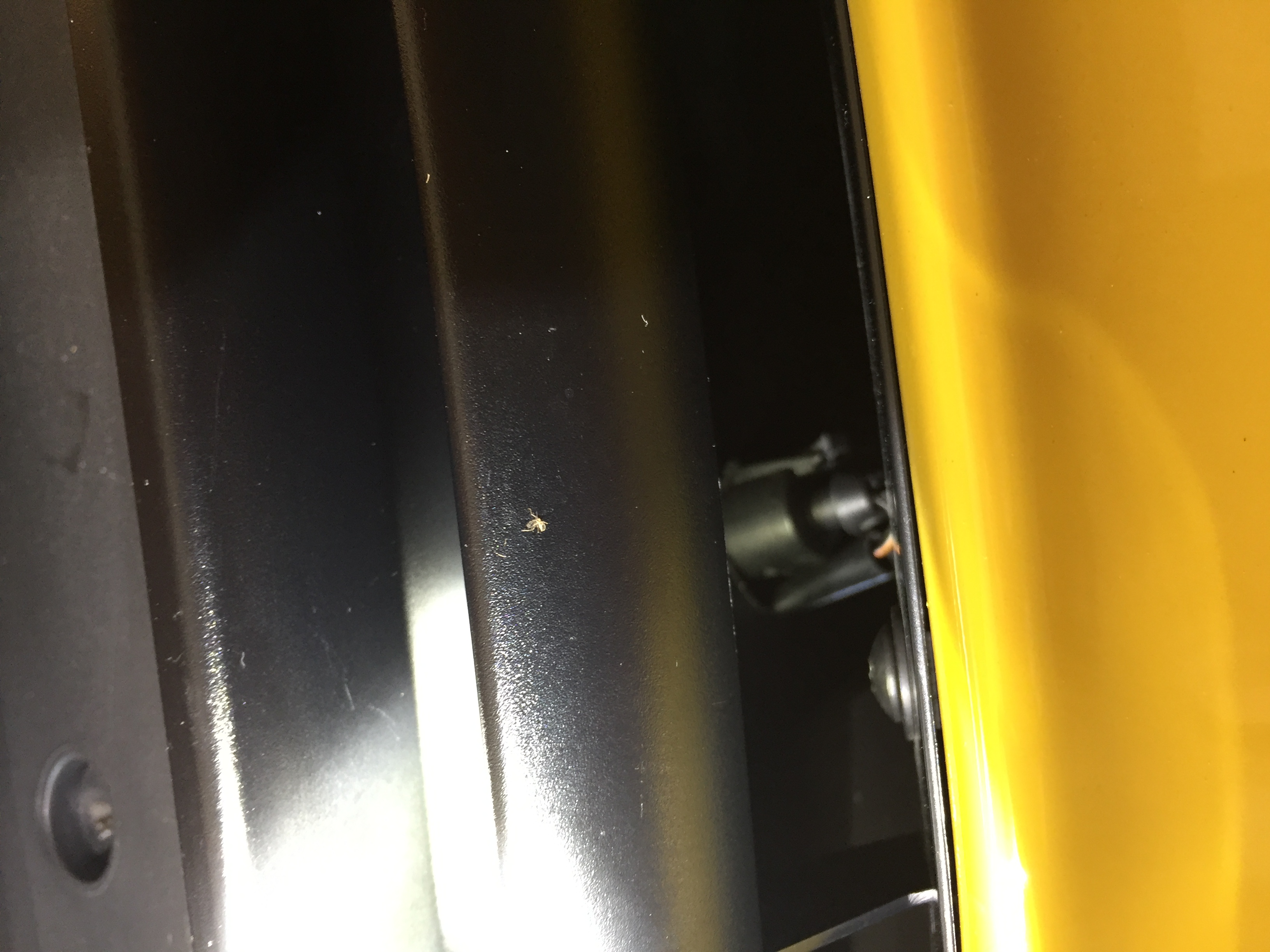

i had to notch my ductwork for the solenoid for the frunk latch. drilled a hole the size of the solenoid so the panel could sit flatter and line up better

Originally Posted by b4stiTTS
Installed the Center Radiator like OEM GT2 Setup, shortened the OEM GT2 water lines and it's working fine. Only way to go, other position is not working
I have also been curious about the alignment. I never found pictures showing the vent to duct alignment. What I do know is the 996 cup has upward vented center radiator that is is just open without directed ducting. So while the goal would be to match factory GT2 ducting alignment, i am not entirely sure it is critical.

I also think that it is ok for the function, just not looking perfect like Porsche normally doing it. Will check it and disassemble everything again

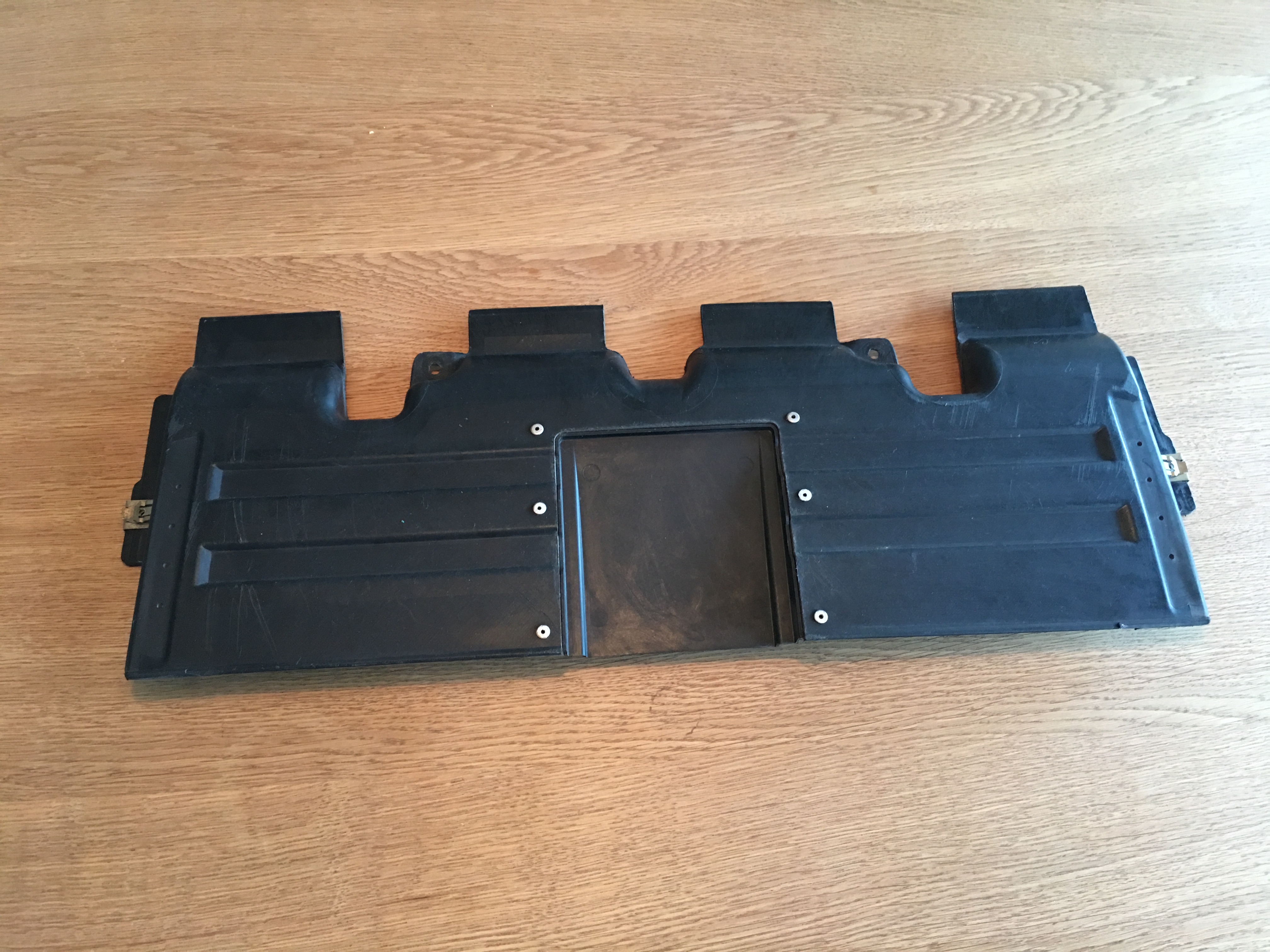

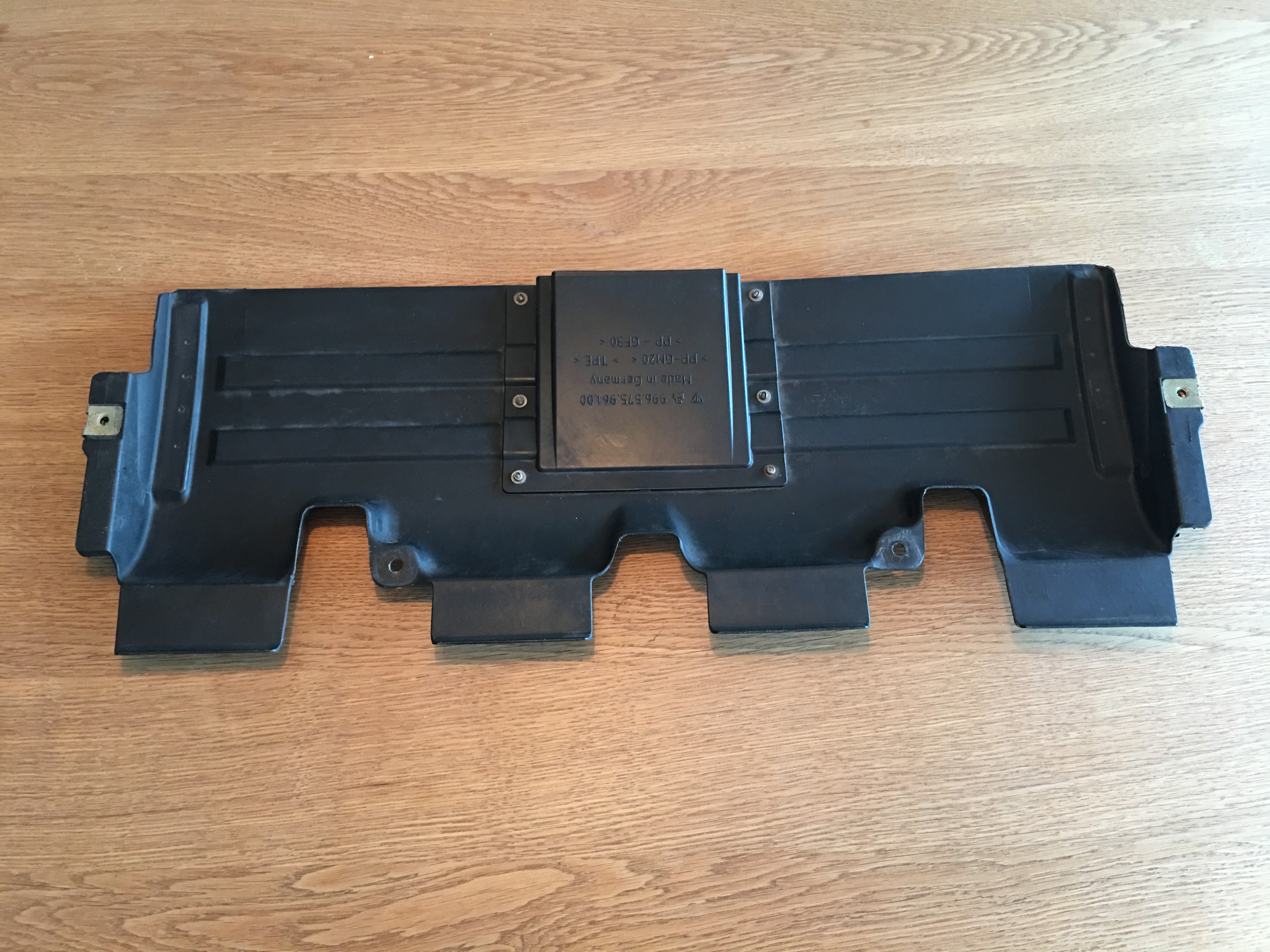

Another question, this Air duct lining for the Underbody has to be installed also with GT2 Front bumper? 996.575.961.00 for the X50 Option and so on

Does not get installed with the GT2 bumper. That is the turbo lower radiator outlet duct. The GT2 factory bumper will interfere with that piece unless modified. The bumper closes off the bottom vent in lieu of an upper vent.

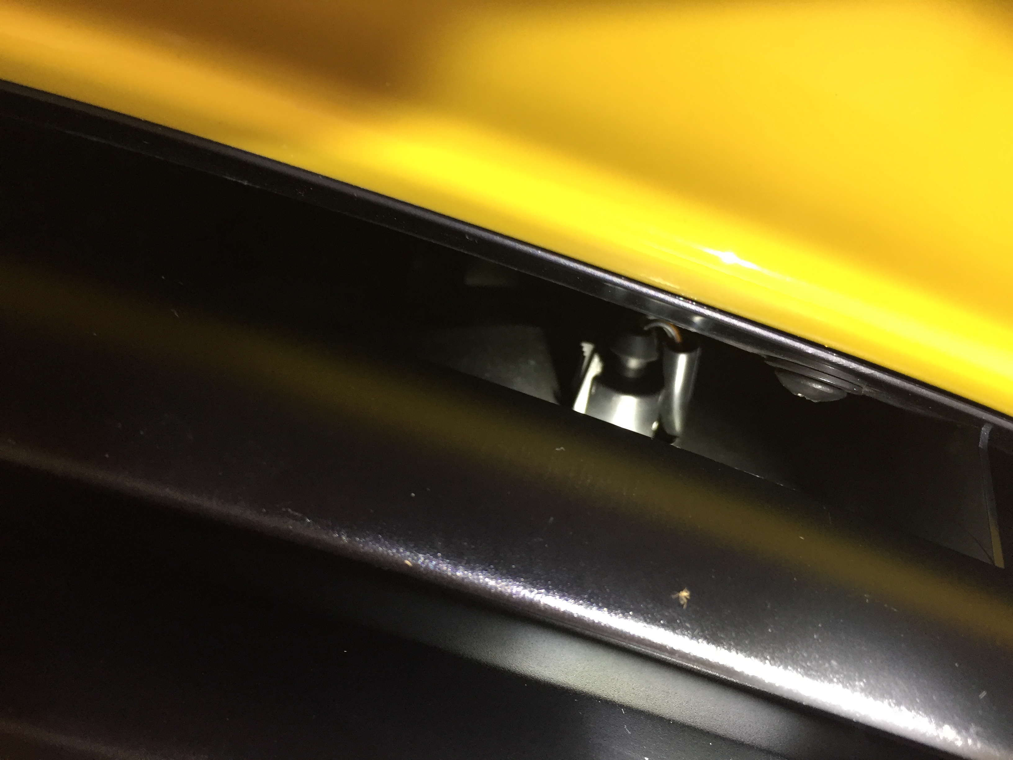

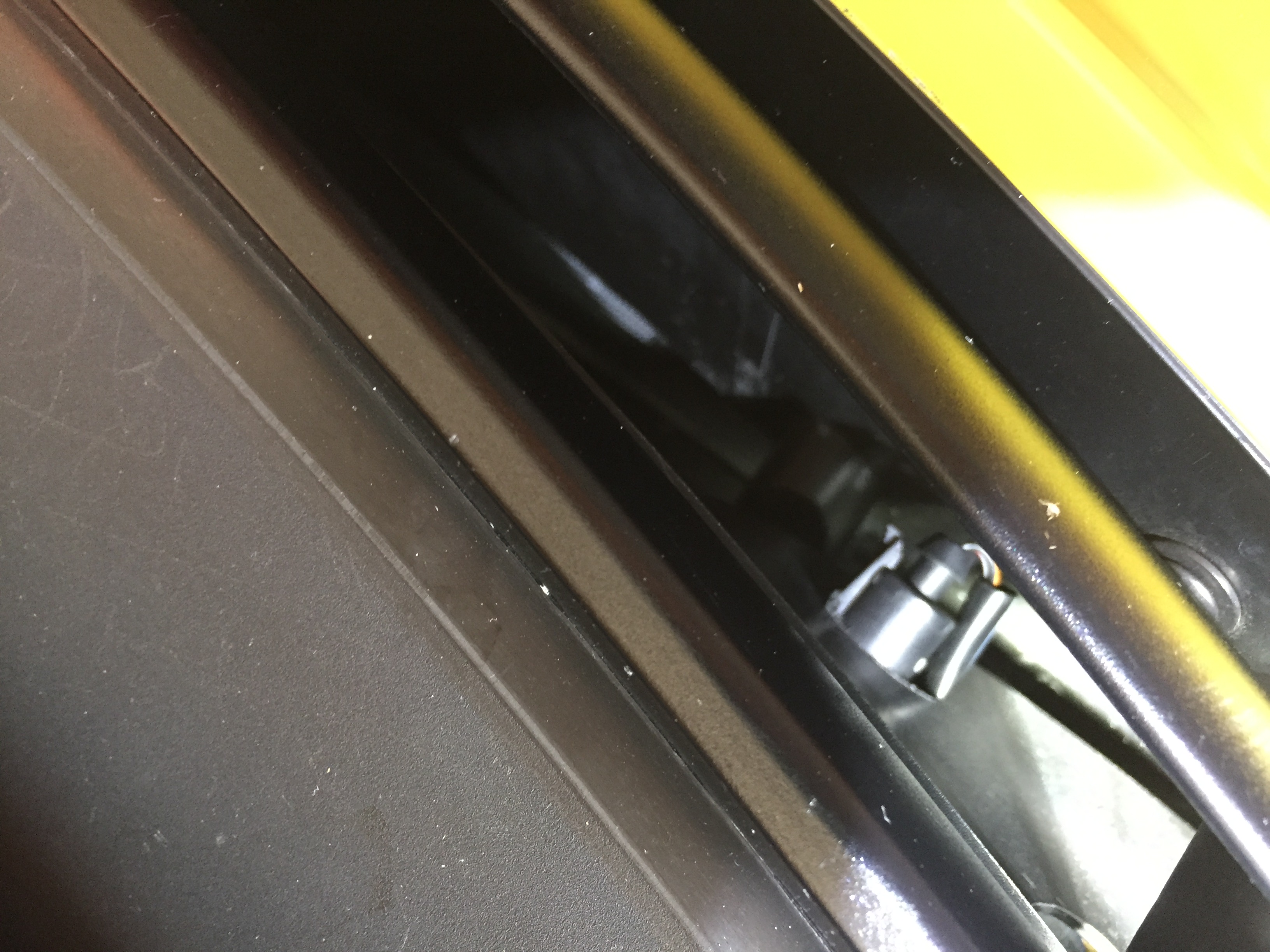

in tried to getb some decent pics but its so dark in there its almost impossible. but here goes.
the first pic is were i drilled a hole to allow the front trunk sensor connector to allow the duct to sit flat against the front framework. see how flat and even it now sits and allows full air to flow up and pout over the hood
if you need it ill try to shine a brighter flashlight into the opening and get a better pic

Old Jul 16, 2017 | 02:48 PM
  #55
VAGscum's Avatar
Joined: Oct 2008
Posts: 1,696
From: Portland Oregon
Rep Power: 188
VAGscum Is a GOD !VAGscum Is a GOD !VAGscum Is a GOD !VAGscum Is a GOD !VAGscum Is a GOD !VAGscum Is a GOD !VAGscum Is a GOD !VAGscum Is a GOD !VAGscum Is a GOD !VAGscum Is a GOD !VAGscum Is a GOD !
I would like some better lit pictures if you could. Specifically showing the duct and the lock mechanism area. I will be addressing some of these areas when I switch from aftermarket GT2 replica bumper to OEM.
Old Jul 16, 2017 | 03:54 PM
  #56
32krazy!'s Avatar
Joined: Dec 2008
Posts: 5,551
From: tn
Rep Power: 628
heres a few about the best i can get. you can see in the last pic how the duct would be forced out against the plug if the hole wasnt drilled in it
Thx, I was thinking the Same and the Front bumper underpanel has a Different shape. But the oem part List was saying that the duct is for modfied stronger motors with 450 and 462 hp, so for my mind also GT2
