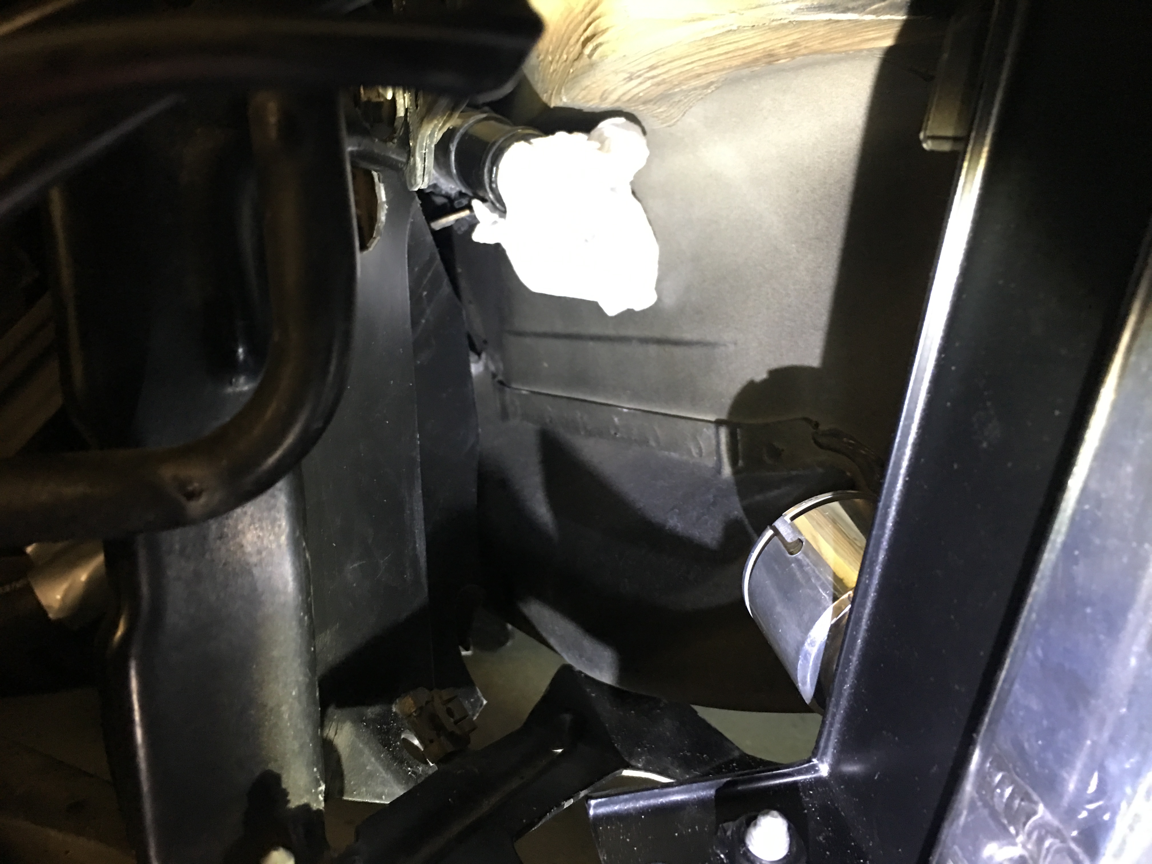

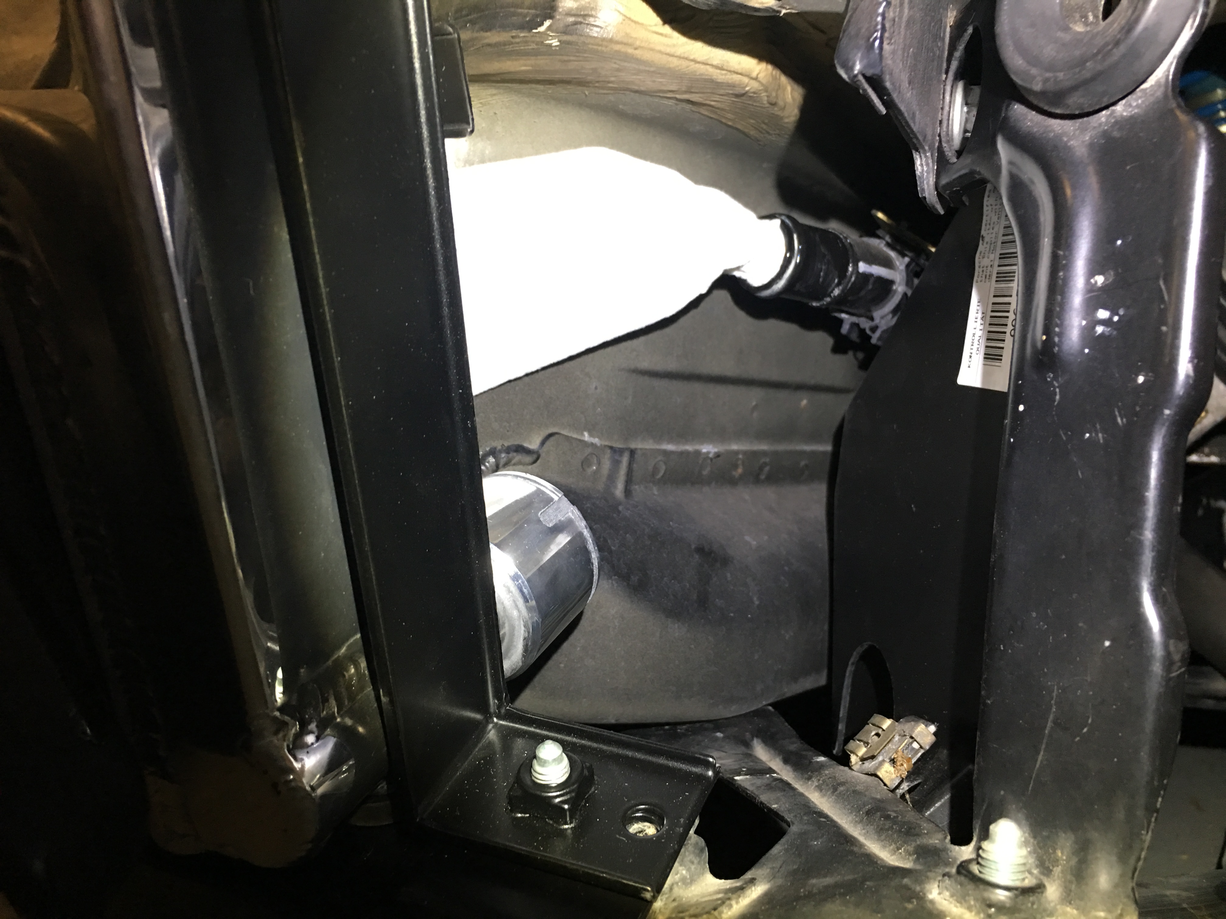

Doing the conversion right now and facing some problems with the water tubes/ connection to the Center radiator. Ordered like recommended in the old posts water tubes 996.106.621.80(Superceded ....75) and 996.106.125.80(Superceded ...75). They are too long and the shape wouldn't be correct for me after shortening in my opinion. Wrong Parts maybe?
Your rad doesn't look flipped. Pretty sure the outlets should be on top. Unless the pic just sucks.
This! Flip the radiators too.

I do not have the water tube (the one with the white rag) on my car. That is only utilized on the TT and can be removed when you do the GT2 conversion. The GT2 water piping does not utilize that pipe as the water hoses are routed along the bottom just aft of the side radiators. The center radiator outlets need to be at the bottom. It looks like yours are. I'm not sure why people are incorrectly telling you to flip the center radiator. Yours is correct.

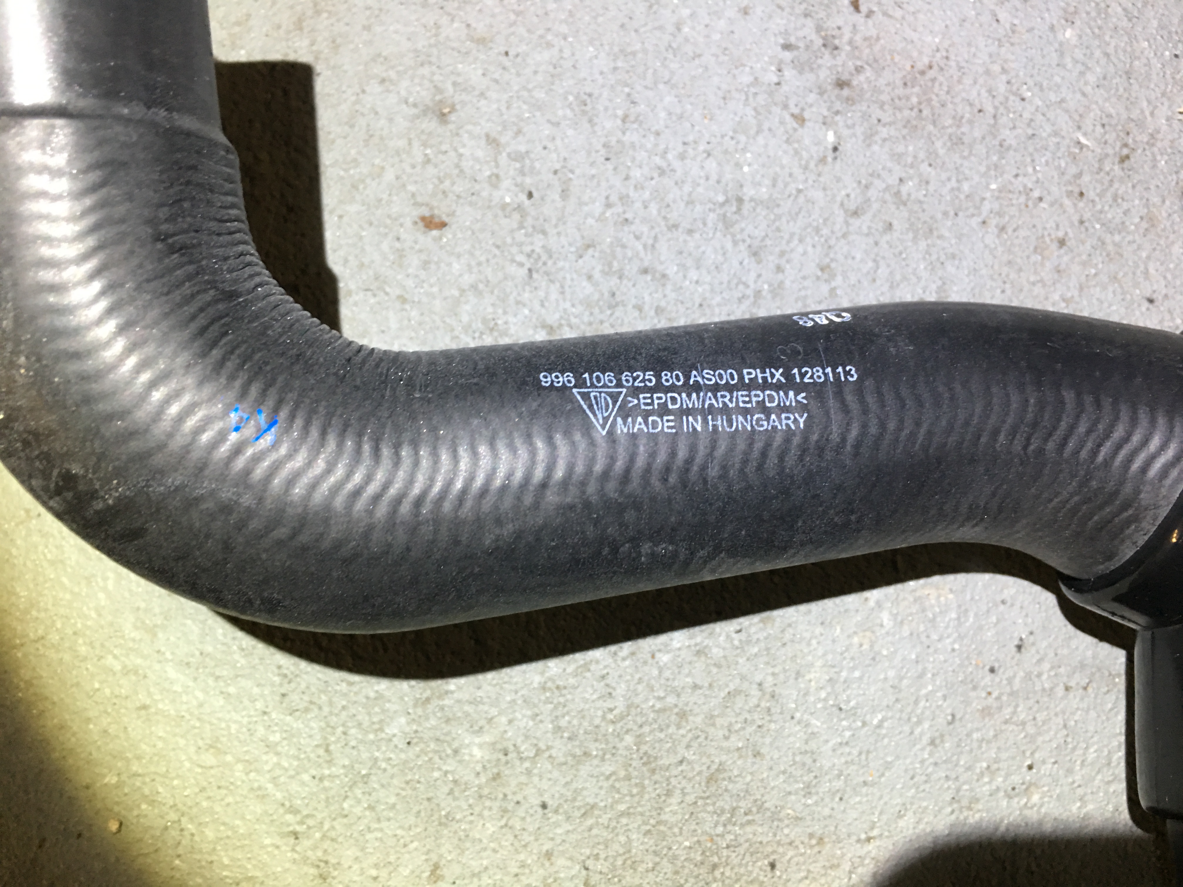

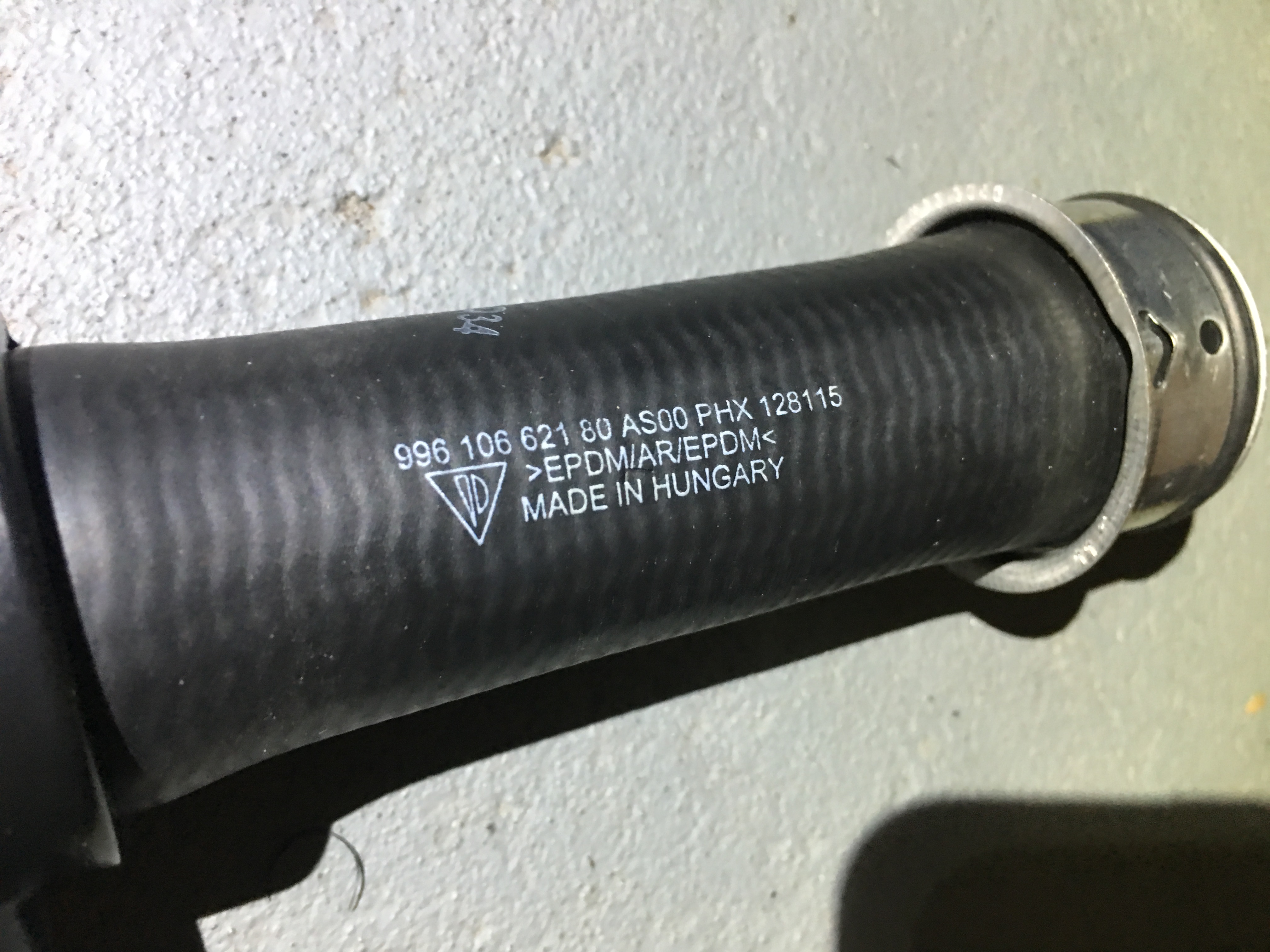

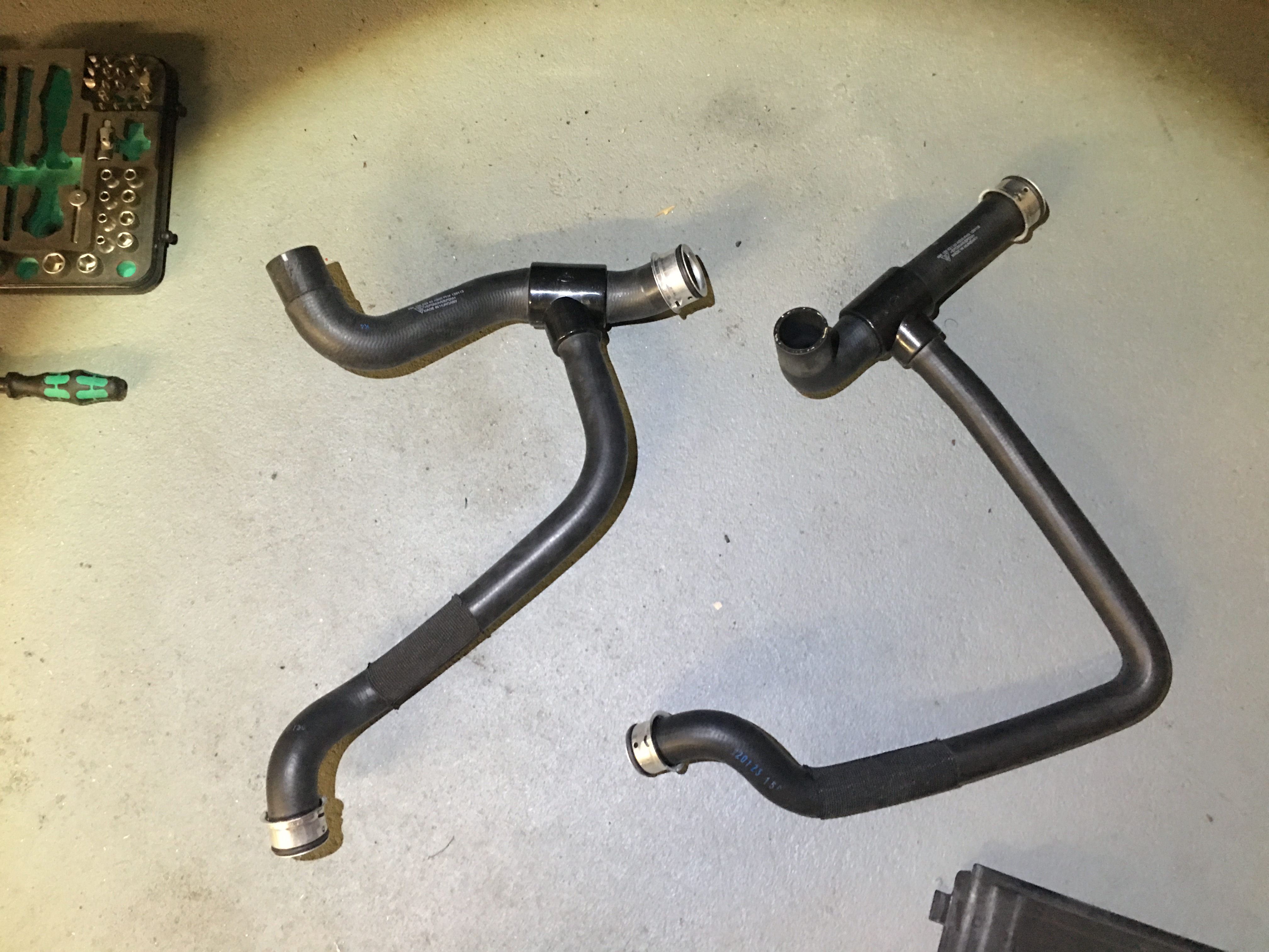

Steve, if done properly, there should be no line cutting. All factory unmodified GT2 hoses are used. It's plug and play. Basically all the hoses from the front inner wheel well forward are GT2 hoses. There are 6 hoses total, 3 per side. The 1st and 2nd picture below has the chimney removed. In the 1st picture you can see the hose (996.106.625.80) exiting the center radiator along the bottom. In the 2nd picture looking from the top, you can see this same water hose exiting the center radiator and bending right along the bottom behind the side radiator on the drivers side. In the 3rd picture, you can see this same hose as it goes further back and T's off to the center radiator.
I think what's happening is guys are cutting and splicing lines to connect to the exiting TT piping that runs along the side of the tub to the front behind the side radiator. I would just swap is all out to the GT2 stuff and avoid turning it into a hack job. There is no reason to do so.
