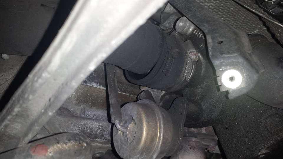

Oh how fancy, you have some bubbles here and there, this is what I started with, after I got my car from previous owner, who had it "tastefully tuned".
BTW, I too would like to order one of those majestic kits, myankelevich at gmail com.
