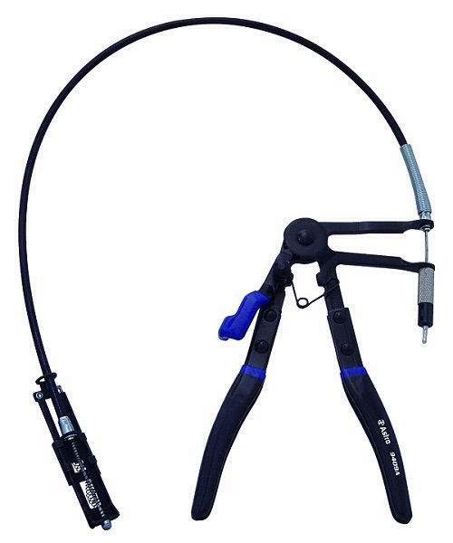

Anyway, I ended up cutting the f hose out with a knife, still couldn't get to the hose clamp on the far diverter valve because the clip was to the front of the car.
Sears makes a nice cable operated hose clamp removal tool for $40. After a hour or two trying to figure out how to get pliers in position, the new tool had the clamp off in 2 minutes!
Pic?

Astro Pneumatic 9409A Hose Clamp Pliers https://www.amazon.com/dp/B003D3N7YW..._pg9sub1JQGCAB

Cool!
Looks like my stocking stuffer item for Christmas.
