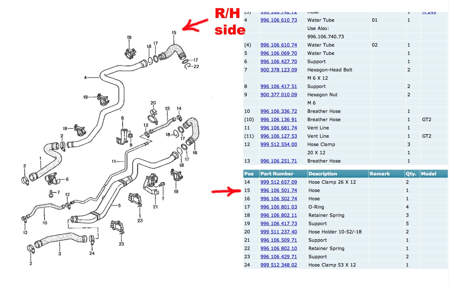

Looking at the rear of the car there is a large coolant hose on the right that comes out of the engine block (like 2 inches thick) can someone help with parts diagrams that I need to replace that hose that exploded and cant find the part number please. 996TT
