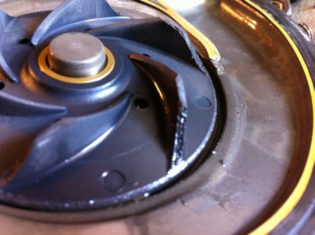

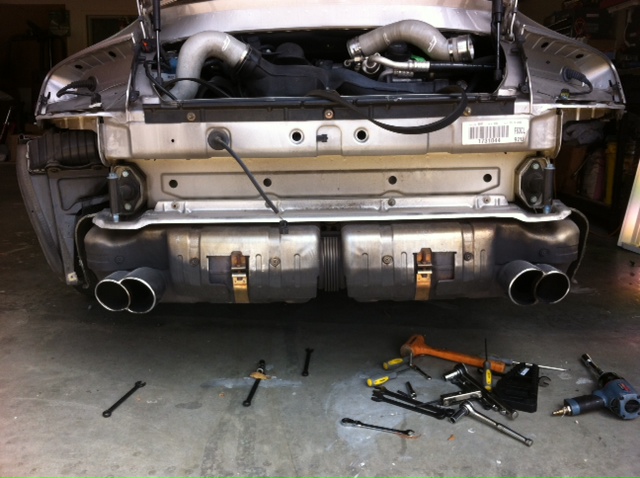

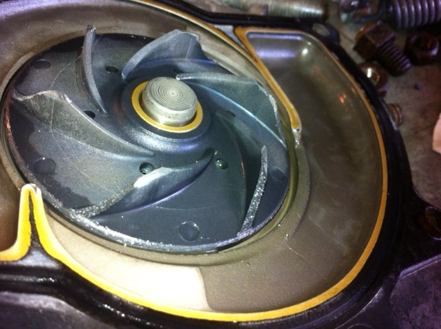

Here are some pics of the watrer pump.
1. On the tubo I found it easier to just take the motor mount off. The motot mount and exhuast mount is in the way, sure some might work around them but I wasn't going to.
2. The water pump is pretty wore out on the edges of the plastic wheel.
3. Doing this for the 1st wasn't that bad really. Just take your time and pay attention to how things come apart and where you put the parts you takle off. I did this in my spare time over about a 4 week time period. I'd say a person who can wrench should be able to do this by themself in about 6 to 8 hrs of steady work.

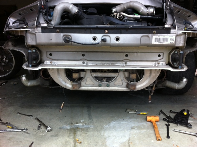

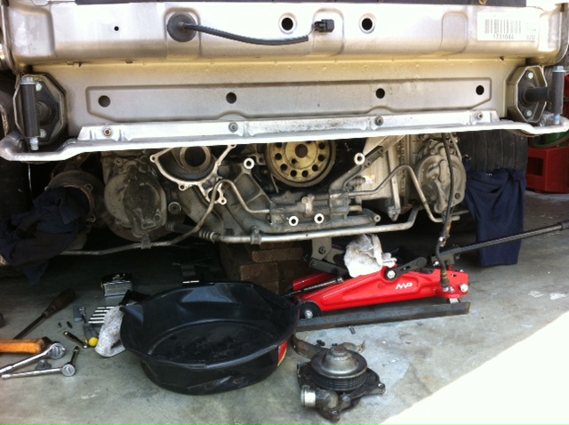

Some more pics

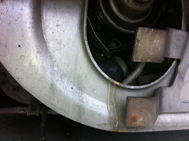

New belt and pump
