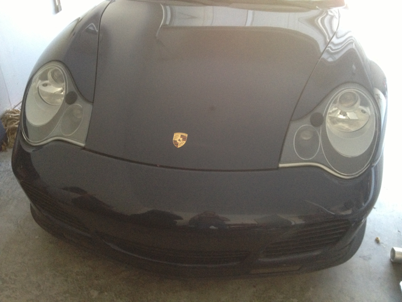

Done. I'm about 85% happy. I think the turn signal tint is too dark. It shines orange through but not much.
If you're looking to eliminate the orange from peeking through, try these...

Not at all. The lenses are tinted. I need a bright bulb to shine through the tint.
