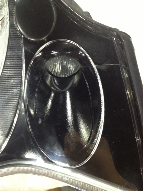

They have offered to return my money and return my headlight. This is what it looks like now. Alot of reflection in the picture, but it obvious in the top right portion that there is still hazing. They have no disclosed to me what they have done to correct this, but claim there is an improvement.
I can still see some hazing towards the bottom left as well. Have not decided what I'm going to do at this point. Maybe I'll request a hi-res pic, with less reflection.

Old Mar 18, 2013 | 11:21 AM
  #119
Hams996TT's Avatar
Joined: Jul 2011
Posts: 311
From: Murphy, TX
Hams996TT is infamous around these partsHams996TT is infamous around these parts
Take the refund and move forward. Separate the headlight yourself and clean up the work.
What else can you really do?
Old Mar 18, 2013 | 11:30 AM
  #120
JSBear's Avatar
Joined: Jul 2009
Posts: 873
From: Laguna Hills, CA
Rep Power: 73
JSBear has a reputation beyond reputeJSBear has a reputation beyond reputeJSBear has a reputation beyond reputeJSBear has a reputation beyond reputeJSBear has a reputation beyond reputeJSBear has a reputation beyond reputeJSBear has a reputation beyond reputeJSBear has a reputation beyond reputeJSBear has a reputation beyond reputeJSBear has a reputation beyond reputeJSBear has a reputation beyond repute
Unfortunately, you may be correct.
I'm certainly considering that option, just running it through my legal channel first.
