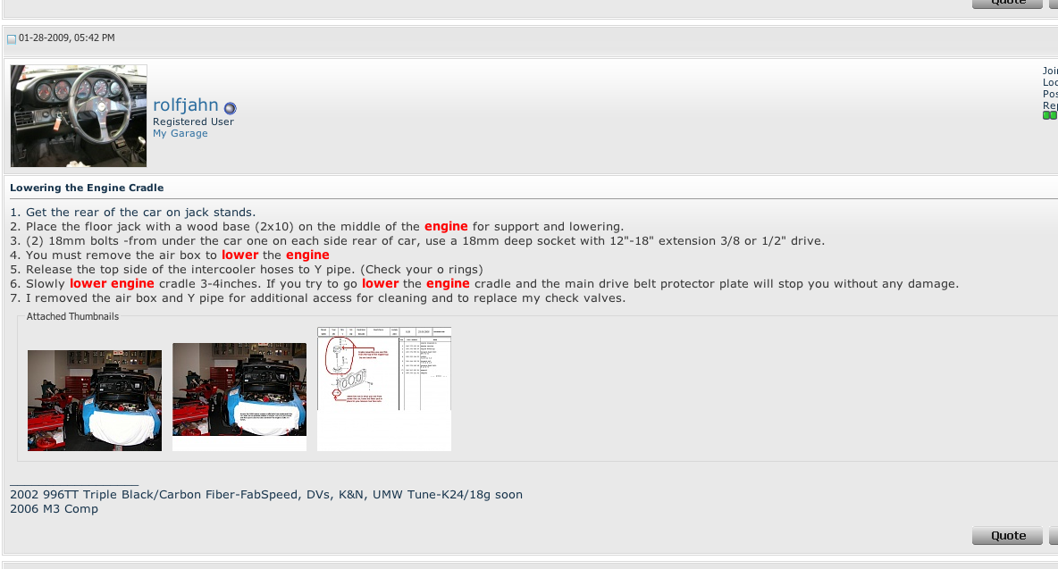

Or just lower the engine 4 inches. It will give you some more room for investigation....

lower engine
Thanks JP. I saw your post previously when I was replacing the F hose and it made things a lot easier. I did lower the engine a bit to give me a little more room for this. I once replaced an F hose without knowing that tip and it was a bear of a job for my big hands.
