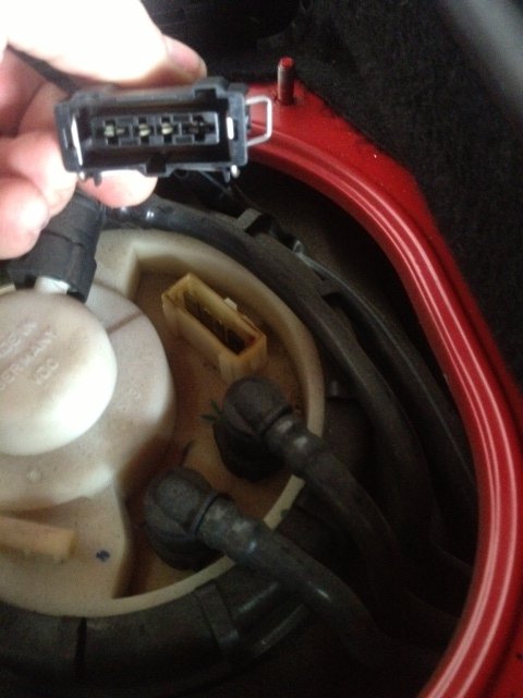

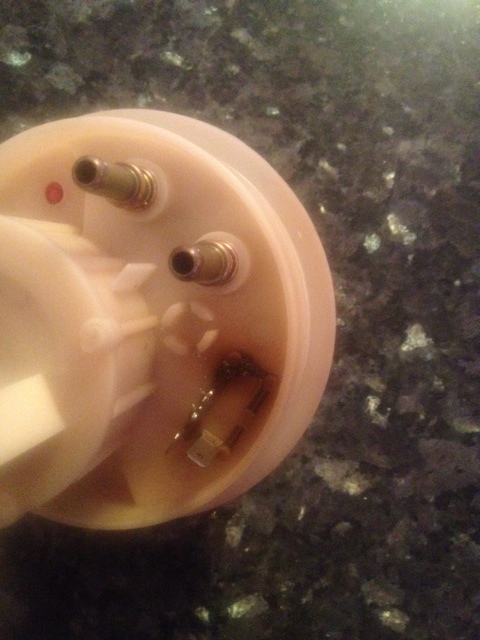

As the thread states, we recently took in a clients car, Randy, who lifted the head for some odd reason when he was on race gas and as he stated only at 1.4 bar.... I WAS SKEPTICAL in the beginning and said one of two things: too much boost or bad gas.... turned out to be neither....
We built the motor and soon after a break in we realized something is wrong... I logged the car and at 1.1 bar it was leaning out. Went straight for the fuel tank, checked the harness and the assembly and found damaged leads which pointed to the pump drawing amperage as it was on its way out... no signs, no signals, no failsafe fuses doing its job... just a blown head gasket with a hole ...
thank God we caught it otherwise it would be the same deal all over again...
