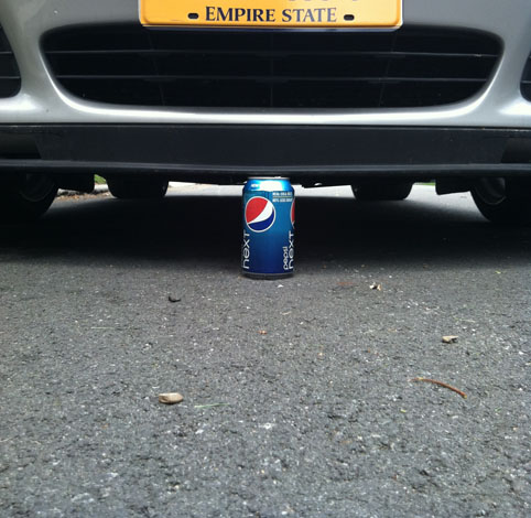

I was able to get within factory Turbo alignment with the H&R street coilovers at the highest possible setting (they run low!) I use my car as a every other weekend car and plan to one or two DE events a year. I don't need the extra negative camber and I wanted to prolong the life of the tires.
