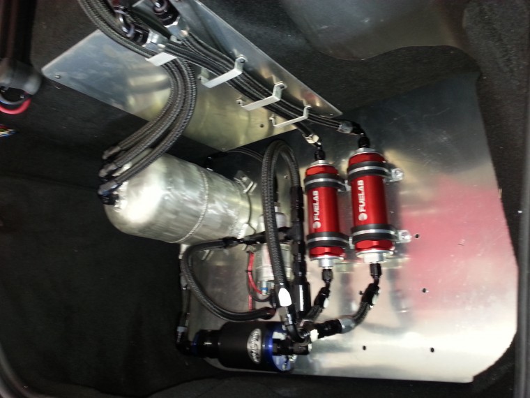

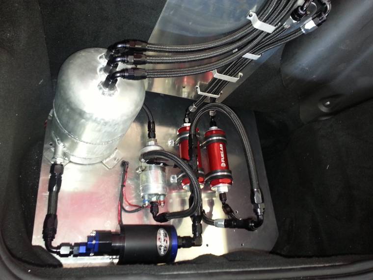

Originally Posted by BiteEmNBeatEm
layinback, do you think you could post some pictures of the new fuel system setup with the magnafuel 750 taking place for one of the 044 on the Radium dual pump set up.
Here ya go:

Originally Posted by layinback
Here ya go:
thanks. the set up looks good.
are you still using the factory fuel pump to fill the surge tank? Is there a reason why you didn't just use the radium tank and switch out one of the pumps to a magnafuel 750?
The radium tank didn't have enough capacity. Errol fabbed a much larger one out of an
old Mercedes hvac unit!
Yes, the factory pump is used to fill the surge tank. The setup utilizes the
factory in tank pump, one 044 pump for daily driving and the magnafuel
for everything above 5psi of boost.
