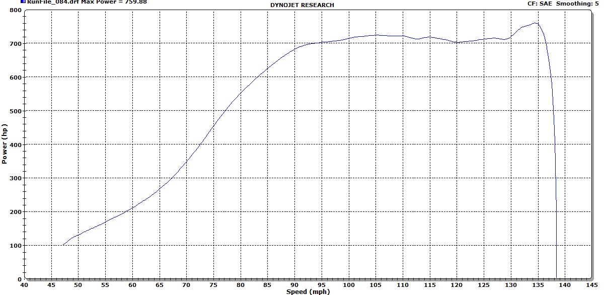

800 on 27 psi is pretty good. I made 800 on 29 on 3076s running out of fuel. I told u that setup is not gonna cut it for ur goals. How did you end up redoing it ?
Post some videos and 60-130s and get those drf run files to overlay dynos.
Mark, was that standard correction, SAE correction, or uncorrected? The screenshot looks like Dynojet's uncorrected numbers - just so any comparisons are apples to apples.
layinback - car sounds like a beast... cool vid on the dyno, too. The exhaust tips look like coffee cans! I bet it's loud...

Mark, was that standard correction, SAE correction, or uncorrected? The screenshot looks like Dynojet's uncorrected numbers - just so any comparisons are apples to apples. layinback - car sounds like a beast... cool vid on the dyno, too. The exhaust tips look like coffee cans! I bet it's loud...
It was a long time ago. I usually use standard correction which is the default from the Dyno shop I use.

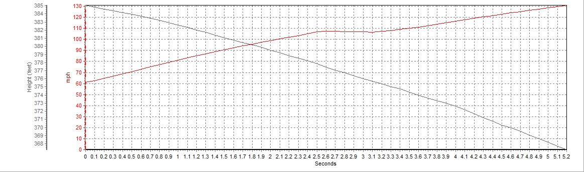

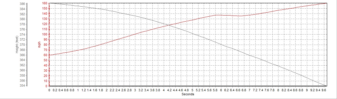

Here are 2 dyno runs. 700 hp @ 25 psi and 800 hp @ 28psi ( It's not 27 psi
as I had originally thought.) Mind you, this was on e70 in 94 degree heat.
The car made 650 whp on 93 pump!
I did a couple runs last night. The 160 mph run and corresponding 5.16 was
a 4th gear pull!!! I wanted to show the flexibility of the 3073s.
The 5.18 run was with a 3-4 shift. I'll post some 4.9s soon. I've done a
few practice runs with the rolling anti-lag and I have no doubt this car will
do mid 4s......maybe even low 4s. I'm 100% confident in a 9 second 1/4
but I think I am a 10 second driver
Name:	800 hp dyno.jpg
ID:	275514   Click image for larger version
Name:	700 hp dyno.jpg
ID:	275515   Click image for larger version
ID:	275516   Click image for larger version
Name:	60-130   5.16  &  60-160   9.62.jpg
