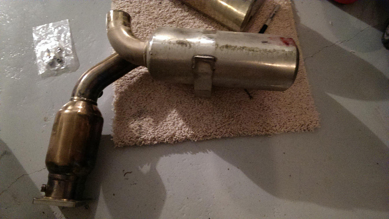

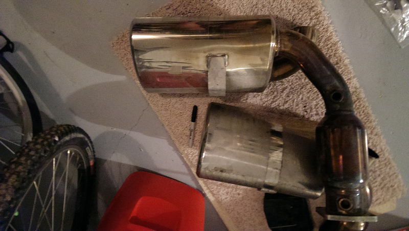

2.) Anyone have any idea what exhaust this is?
Sorry for the potato phone pics, I can take better ones, or of specific things tomorrow.
Work order for the install says it's a Tubi, but there's no stamping or logo anywhere on the set. Quality looks good, but I don't know for sure what it is!

looks like tubi exhaust. no need to retune if you went back to oem but there may be a slight power loss

thats not a Tubi exhaust.. seen it sold for years under different names ( if it was a FVD or cargraphics if would have a tag), but that one is seems like its the cheap asian imitation...
just from what I see..

That is not a Tubi exhaust, maybe a Fabspeed?
