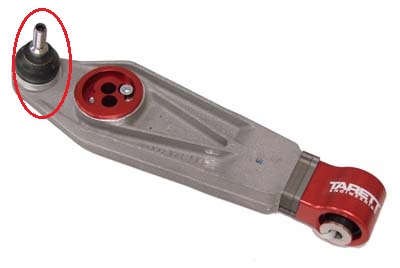

Attached a photo of the outter LCA circling the tie rod. Is this the part that can be replaced OEM for 70/side? Would you happen to know the part number, can't seem to find it. thanks.

When you said tie rod I thought you meant the steering tie rod. What you have circled is the outer lower control arm ball joint. Those are not replaceable.

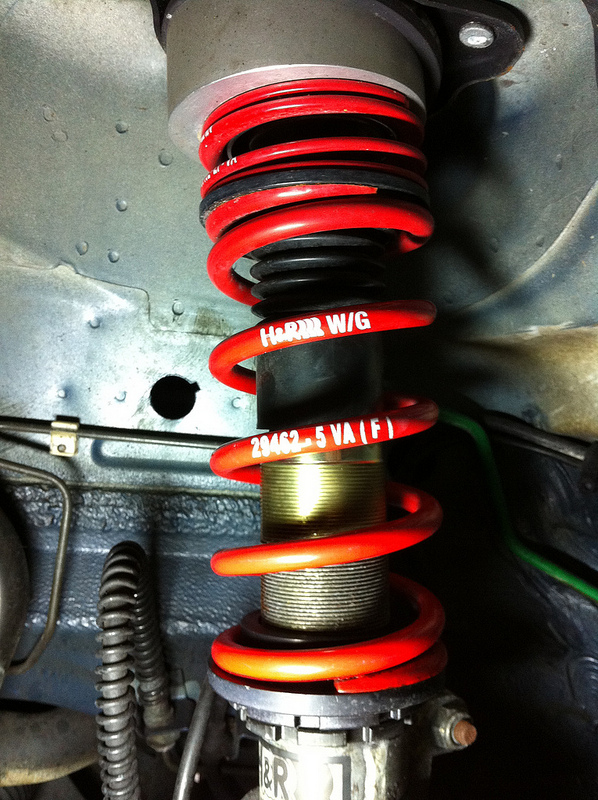

They are the street coilovers. The old version used to be slammed but then they revised the front shocks to remedy this. The older ones used stock front perches with conical shaped springs like the stock ones. Click image for larger version

2009 timeframe. Give or take a year. This is a picture of the new version fronts:

Not sure when. However, the best thing is to look at the front springs and see if they are ~10 inches wide or 5 inches. The distributors of these sometimes had old stock that they sold fora discounted price after H&R updated to the newer perches. So dating the ones you are looking at or own bases in when it was purchased is not the best way.
