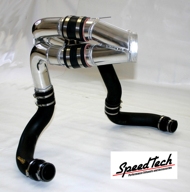

Originally Posted by brichacek
The GT2 conversion I will be doing as well. For intake piping I was leaning towards a Y-pipe of some kind?
You would be much better off putting in a Hi-Flow intake plenum with enlarged piping to help feed your new turbos additional air. You can easily install a Y-Pipe with the motor in the car any time - it's a lot more difficult to install a plenum with the motor in and IMO, it's a better mod for you at this stage, than a Y-Pipe.
Here is an example of our premium SpeedTech Hi-Flow Plenum with hard piping - this is what I would recommend:
Plenum Web Link: http://www.speedtechexhausts.com/ast1_018.htm

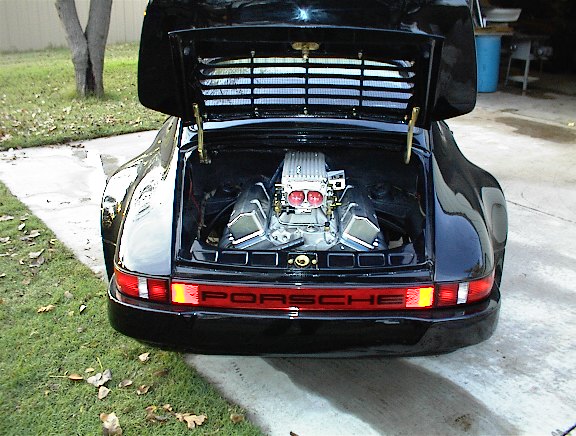

z06801 has a reputation beyond reputez06801 has a reputation beyond reputez06801 has a reputation beyond reputez06801 has a reputation beyond reputez06801 has a reputation beyond reputez06801 has a reputation beyond reputez06801 has a reputation beyond reputez06801 has a reputation beyond reputez06801 has a reputation beyond reputez06801 has a reputation beyond reputez06801 has a reputation beyond repute
Originally Posted by PAULIEWALNUTS
thats what i was going to say put a LS7 back in, I'm actually putting a LS into my sons 944 turbo, don't know if I could do it to the 911. Check water pump for signs of leaking
