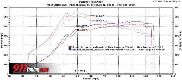

three of my builds on 3 different dynos. 2 of which are dynojets
and the other is a mustang. The dynojets are within 10 hp and the
mustang is always around 15 hp lower than the dynojets.
One of the fellows has a dyno day ever so often and plenty Porsche
club members attend. The stock 996 turbos are all between 360-370
according to the owner. Of course this equates to around 12-13%
We all know that chassis dynos aren't anything like an exact science
but rather, they're a good reference point.
btw, that's rear wheel numbers.

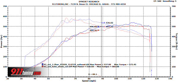

You find both figures on my chart. The dyno has measured both. This is no guess.
The car is breaking the heavy roll of dyno, so there also is friction in play. I understand what you would like to say with the friction argument, but given that the measured drivetrain loss of my car was only 20 HP while breaking the drum of the dyno, let's me think that the plain guessed figure of 15% without any backup or validation is too high.
Power to the wheel is what counts and your 680ish is already very high for this turbo. 1.7 bar and this small turbo is a stretch in my book. IATs and timing would be interesting to see.
Andreas
Andreas

markski
here.. you go.. dosnt make power? lol please...
93octane pull
100octane pull
2001 996TT 3.6L and stock ECU
9.66 seconds @ 147.76 mph 1/4 mile click to view
