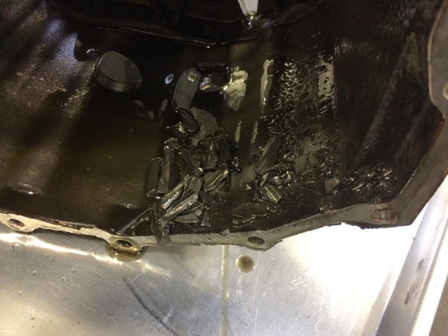

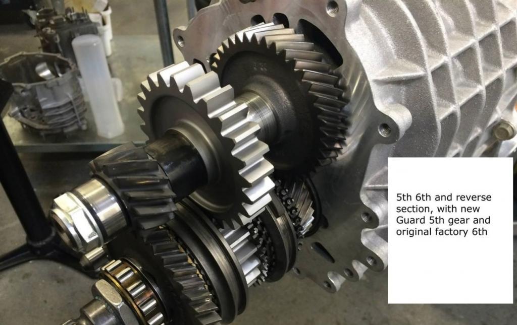

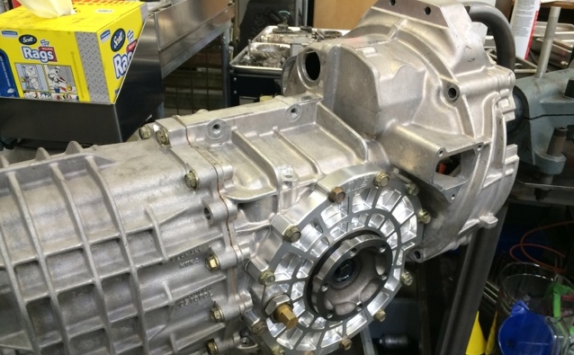

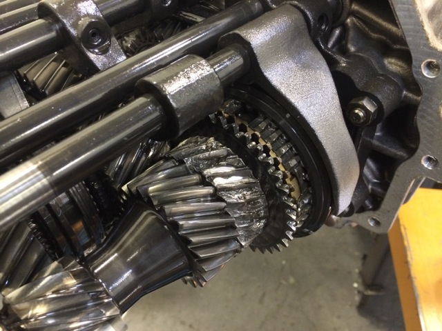

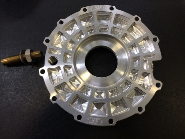

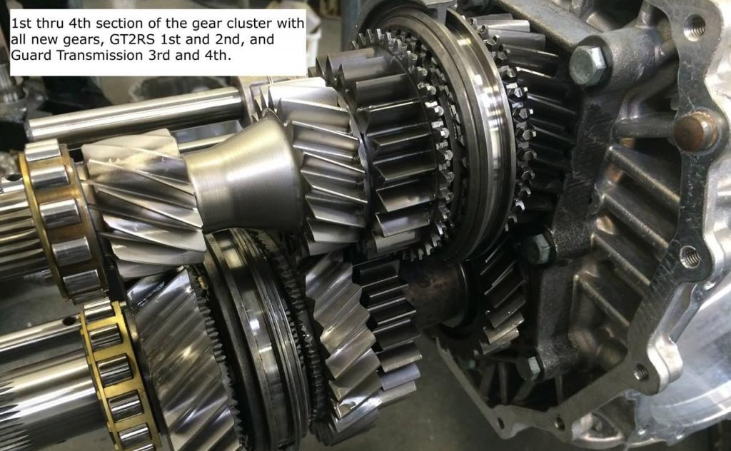

After getting the car back, I was excited to feel the new power at the track rental. On the way to the track, on the first small pull in 3rd gear, the trans gave up! Tore every tooth off of third gear! So, the trans went to Bill Rader Motorsports in Las Vegas. And with help from Guard Transmission, he put together a monster gear box. Includes all new gears 1-6. GT2RS main shaft with 1-2nd gear. Straight cut 3-5 gears. All new steel gear under bearings, GT3 shift lever, Billet LSD housing and Guard internals and Billet side cover. Pics of before and after:

nice build. why not replace the retaining plate with a forged GT3/2 RS one?
did you damage center case? i broke my tranny in the exact same way and center case had hairline cracks and retaining plate was just a little deformed to.

It doesnt happen overnight and i dont think it was a QC issue, those usually come up ealy on into the ownership of a car. A lot of guys here have broken 3 gear, its a "weak" point in our trans. Even with that said how many other trannies on the market can hold 1000whp. I beat on mine for years before it broke so did BHT.
