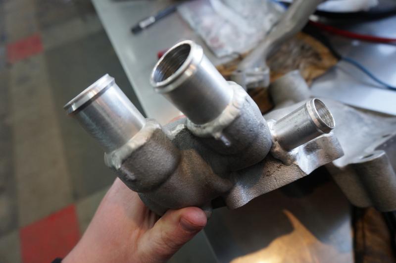

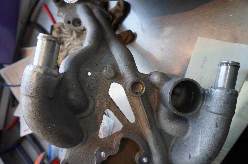

First of all it is the biggest PITA job i have ever done. I decided to do the welding solution. I did it as a preventive maintenance, i did not have a fitting pop out but because i track the car and had the time this winter, i figured i might has well do it and be reassured.
From what i can see, not all cars were created equal, while many had fittings poping out or some falling in their hand while removing them, mine were very well glued and i must admit i did this for nothing, they were so well glued that i doubt they would have popped out. You can see the pics of the amount of glue there was. I had to heat them up a lot to remove them. On the water pump housing, my little propane torch wasn't enough, i had to use the real torch to get them out.
Anyway, just wanted to say that if you intend of doing it the welded way, PLEASE test it before putting the engine back in the car. I had many pin holes and everytime i fixed one, an other one appeared. There were all very small pin hole but still, i had to go back to the welder 5 times with parts because i had a pin hole. My welder was very good but the quality of the casting is not so everytime a small impurity in the casting would burn, it would do a hole. I even had holes in the fittings i bought to do the job...
so i pressure tested the system to 10 PSI (didn't do more as i was afraid the tool would blow out of place in my face) and it is finally holding pressure (letting it sit as i am typing this to kill some time). You just pressurize the system and cover everything with soapy water. I even found a leak with one of the o-rings that moved while i was installing parts, never would have known with the engine in the car.
I can tell you the welder was fed up of seeing me and he really didn't know what else to do

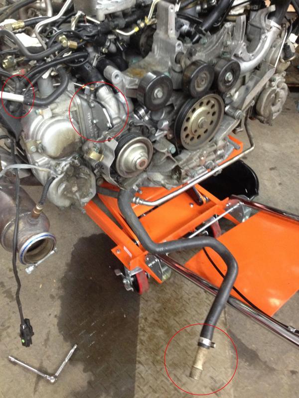

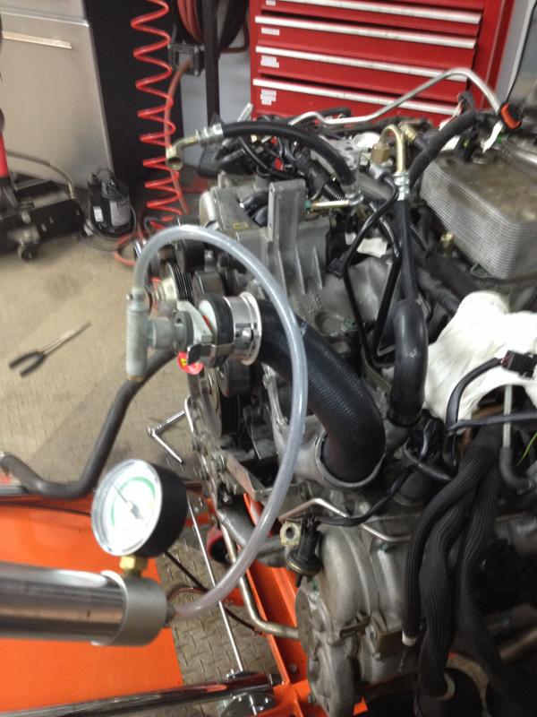

As far as how to test it, the best way is to have a friend like JPflip near by, yeah i know, not everyone has that chance. I was able to borrow his tool which is a bluepoint SVT275
you can see it in the first pic, basically i installed one hose and you put the tool in it and pressurize the bladder which will seal inside the hose. Then you can pressurize the system with the tool. In the other pic you can see the places you need to cap in order to pressurize the system. It is missing the two heater hoses next to the transmission that you have to plug also, i just put a piece a pipe and connected them together.
By the way, been 30 minutes now and didn't lose any pressure I think i am good finally...
sorry for the crappy pics, just had my phone on me.

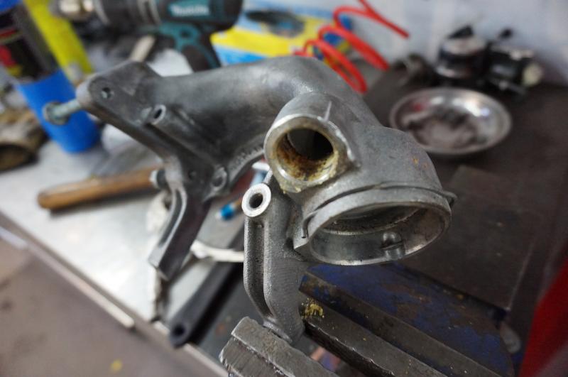

I hit all the areas with a rotary burr even around the casting. No sign or hint of glue can be left behind. Clean everything with acetone. No sand paper as it can leave a residue. Best is rotary burr and scotch brite.

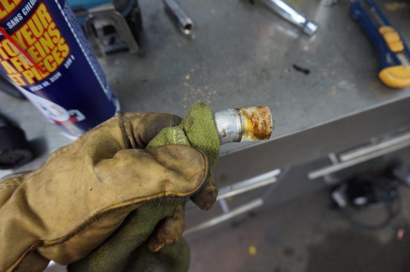

Mine would have never popped out considering the amount of glue i had but i had to remove them to know it. Some weren't so lucky and had a lot less glue than mine, i was afraid of being in that group. Unfortunatly, there is no way to know in which camp you are unless you do the job...
