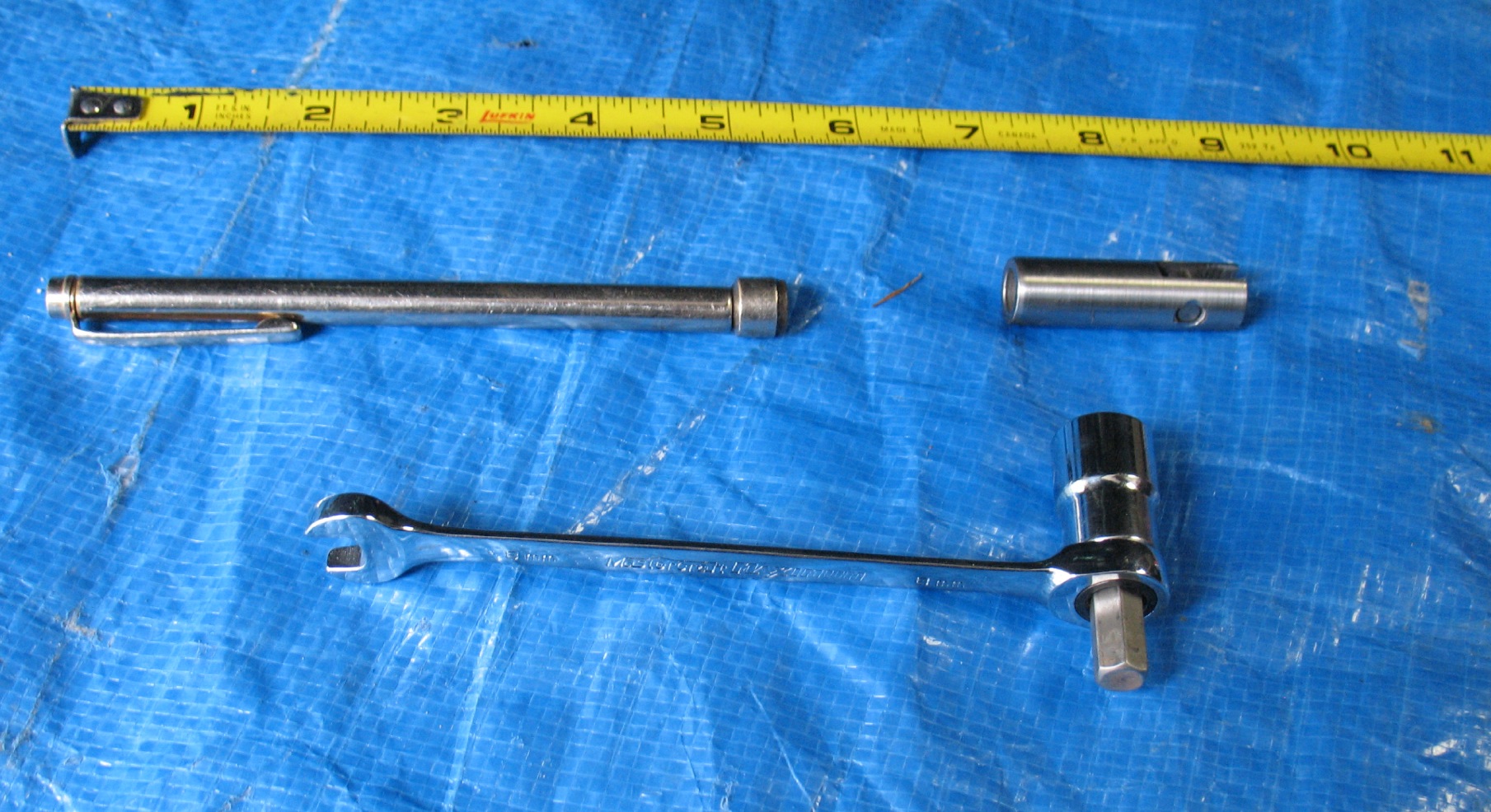

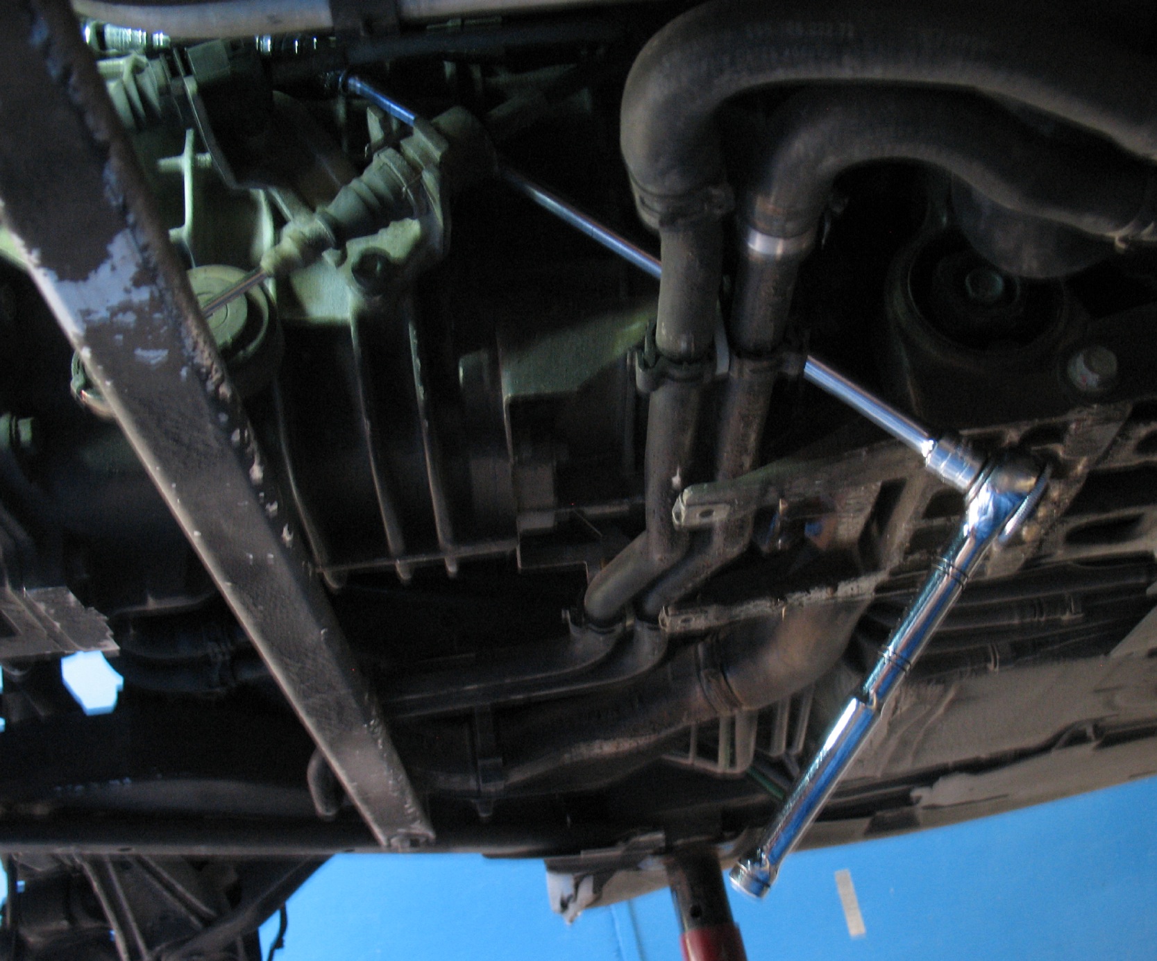

These are the tools I have used for this job. I had to put a pipe at the end of my ratchet to get the plug loose.
Did you lower the trans any? I didn't have room for a wrench that long.
Later, Steve
Later, Steve
No Steve. I did not. But have to admit, it was really tight and at one point I was not sure if I was going to be able to loosen that plug….
