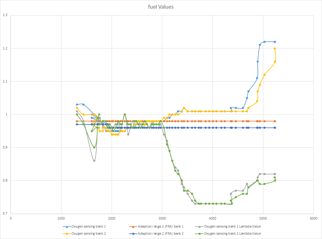

Originally Posted by ~eXo~
Injector? You sure it's not a coil? You'd be less likely to run richif it was an injector failure. That should cause you to run lean.
Yes and/or coils, Protomotive did some charts of my fueling and we think more likely that
Sorry, on the Durametric there is a measure of cylinder misfire and cylinder rough running, on 1 test I had one cylinder showing a misfire, another run it was a different misfire and then on the rough running cylinder measure I got values from -3.3 to as high as 6 across each cylinder... trouble is I cannot find what the measure means and what is normal for a 996 TT S

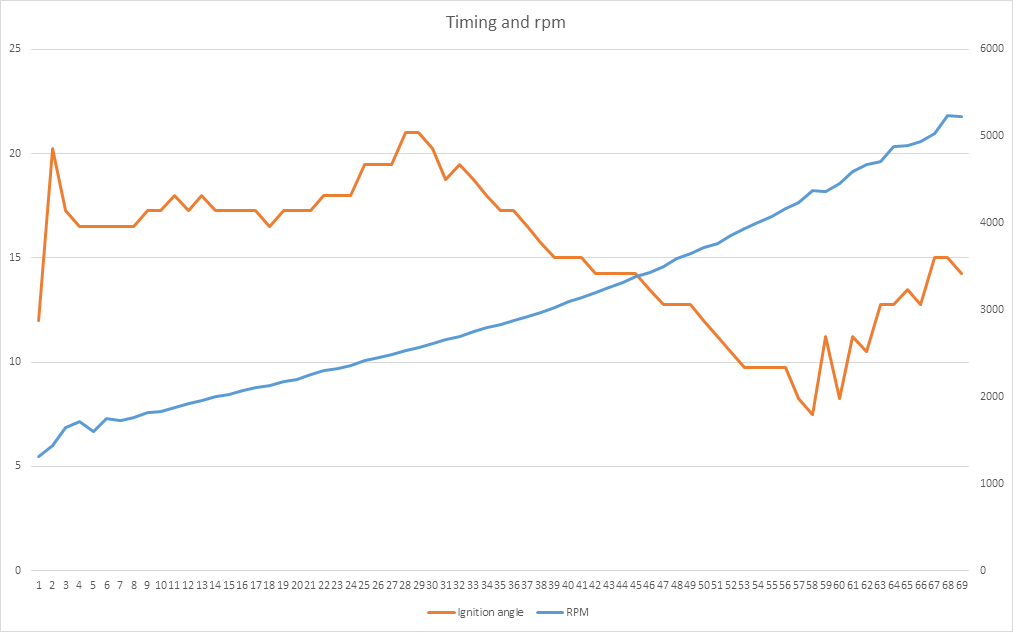

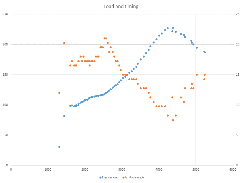

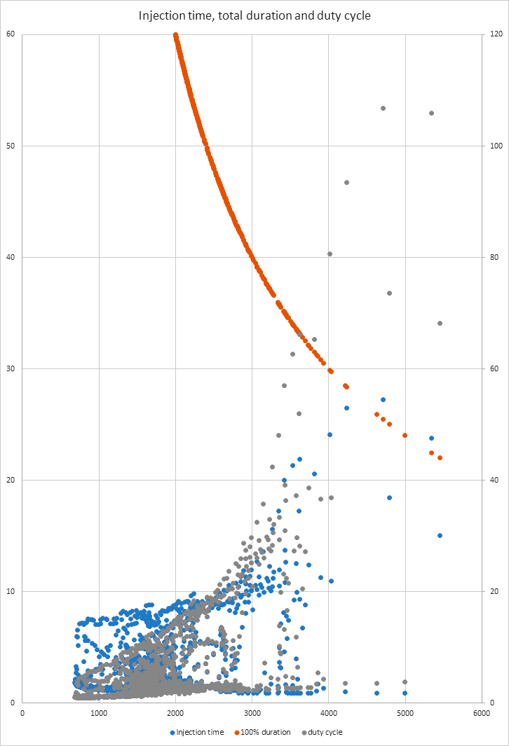

This is some of the charts from my Durametric tests
Seem to think the car wants to pull in a LOT more fuel and the system says nope, I am maxxed out baby
