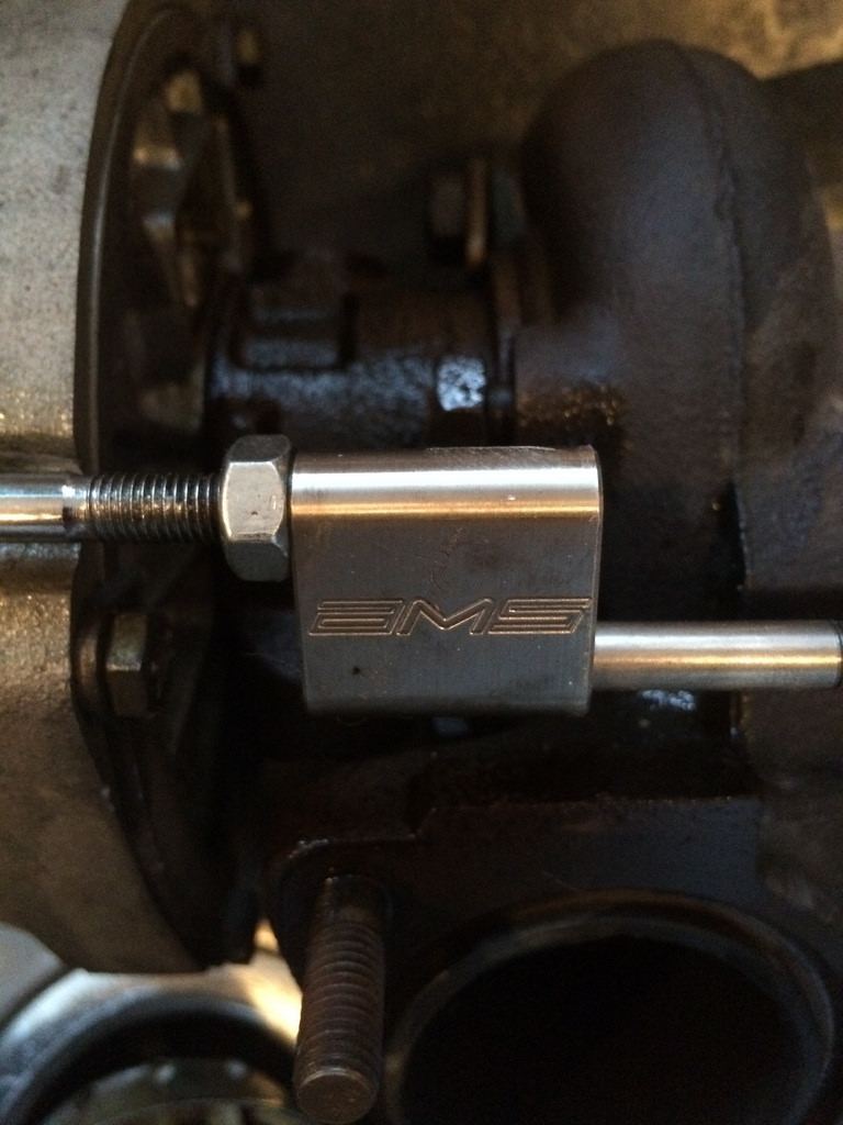

If i was hitting 1.1 bar on my EVO tune before the new turbos went in, could a boost leak be created after the install? or is it possible these wastegates just aren't 'setup' for 1 bar? Is there adjustment to them or do they just bolt on and they are set at 1bar?

Tony will get you there. You need to use a mighty vac in the psi setting and check the cracking psi of each wg. Yes you can adjust by simply loosening the nut between the waste gate and the arm then tighten the nut on the end till it cracks at 14-15psi then tighten up the first nut you loosened to the arm. I would guess it is just the gates are not adjust correctly.
