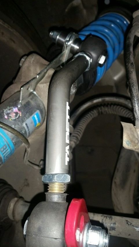

Stick with OEM front drop links (or whatever came with your coil overs) and get some rear Tarett adjustable DLs... The thick front adjustable drop links often create a lot of clearance issues with the AWD uprights so it's simpler to not open up that can of worms...

Custom Tarrett DL's arrived today and fitted today :-) . Had to do a small mod, see pics. No more binding, yippee.
996TT with the AWD really need these bent links, the straight ones do not work, believe me I've tried every angle, spacers and length. The PSS10 ones do not work with the Eibach sways either, they were over stretched and badly split on the rubber dust cover.
Ira at Tarrett was amazing to deal with and can not thank him enough for his excellent service.
