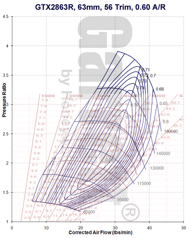

Ended up with gtx2863 t3 header and .64 garrett housings, vband exhaust 2/5", looking forward to put them on, unfortunately the gtx2867 werent on stock for a long time and decided to go one step smaller, even they are a better fit for a 3.6L stock cam and 7250rpms redline than the 67s regarding track performance
As Hydra said, they are the perfect fit for my stock like engine (no heads work, stock piston with rods and studs), please see attached pic, there is also the old gt2871 small trim48 and 1.8L engine plots
After my calculation and considering just 0.9-0.93 efficiency the engine will flow 42-43lbs @7000rpms @29psi and about 44lbs @7500... So the turbos should be able to feed the engine till 6800-7000rpms or so, considering the turbine will be able to evacuate properly
Anyway I expect 24-25psi (1.7bar) to be the sweet spot for these turbos with some decent timing on 93pump+50meth, anyway the free flow exhaust, big ICs, big intake....should help.
Going back to 4WD as want to use MPS Cups 2 and they are available on stock sizes, also I got a great price on MPSC2s @996tt sizes compared to R888s @996gt2 sizes
By the end of next week I should be able to share some impressions follwed soon by new dyno runs, if reaching 600hp crank @1.3bar and 750+hp @1.7-1.8bar and keeping the boost up on top but with the best spool down, I would me more than happy
