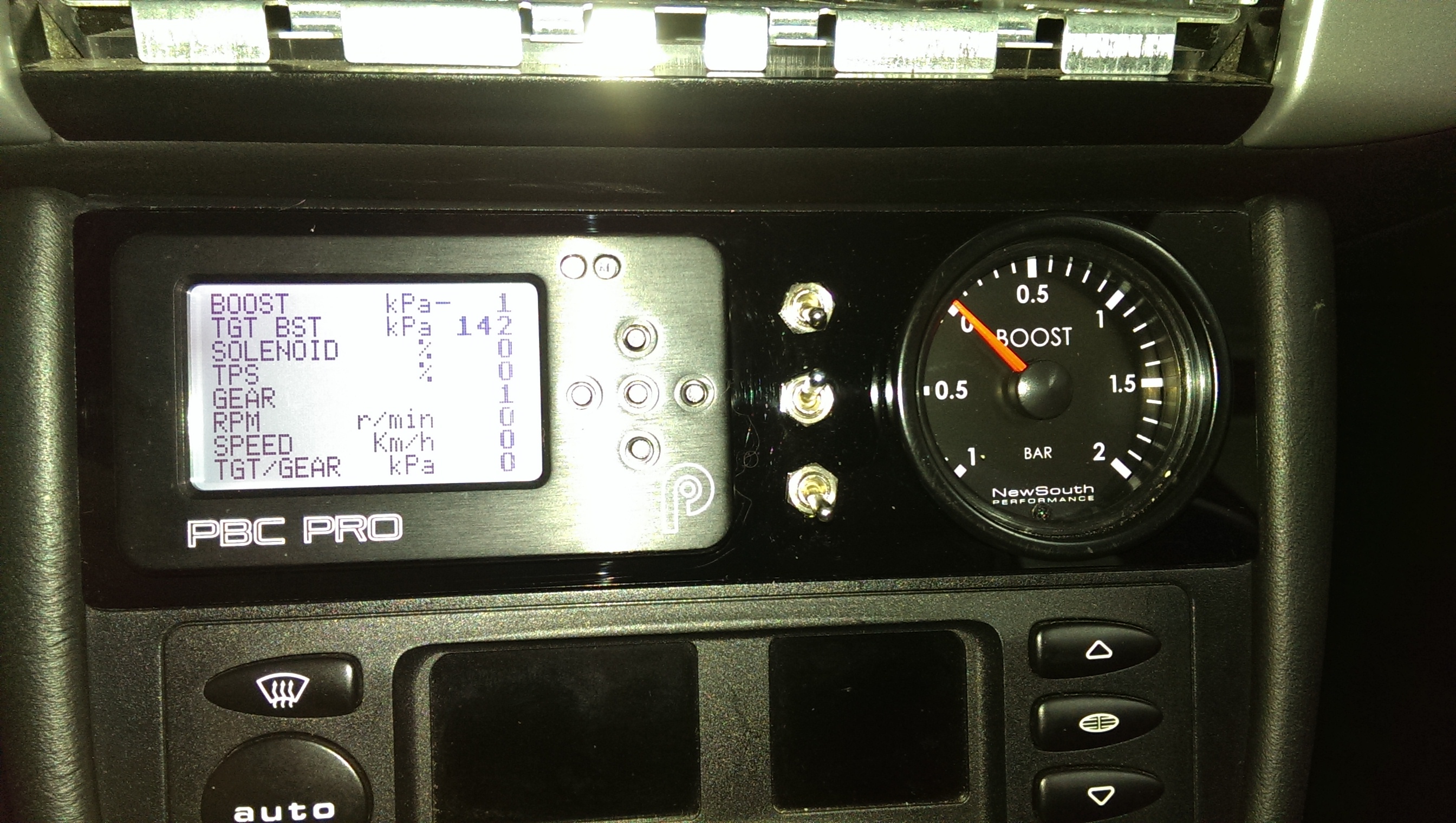

100% agree. I think they currently have the best controller on the market. Not the best pic, but this is how I mounted it:

I just did the same setup by relocating the greddy above the A/C controls, have one red switch to enable/disable high boost.
What are those switches for? I like your setup and might go the same route, what were the main benefits using Plex and what which EBC was before it ?
Your is is RWD right ? I see this EBC almost like a stand alone without the traction control features, but anyway guess psm totally off is the way to go

The middle switch is BC on/off, with off being boost given by the spring of the wastegate when you start the car (kind of disarmed mode ). On then enables the lower switch which selects low/high boost.
Off on the middle switch also allows to change manually to RACE.
I had the HKS EVC 6 before. Also nice, but not near when it comes to features. I need boost by gear as kind of traction control (RWD) - that was the main reason for the change and I got a lot more.

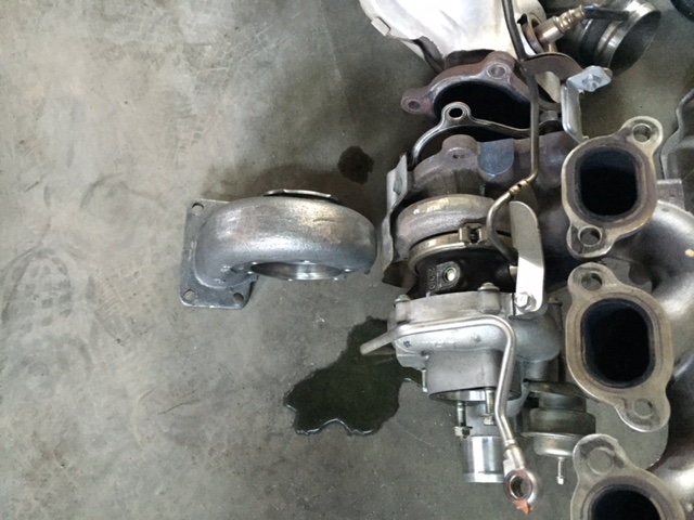

the new gtx turbos have arrived, which one to keep left or right ?
left gtx3076
right gtx2863
hotside by garrett .64 T3 (gt28) compared to OEM turbos from the gt-r
the gtx3076 are very similar in size to my actual turbos used for 996tt
expected the gtx2863 compressor cover to be smaller
Compared to oem gt-r turbos the gtx2863 are way bigger, guess will get easily 700hp crank for track events, maybe even without meth, will log everything asap and let you know guys
