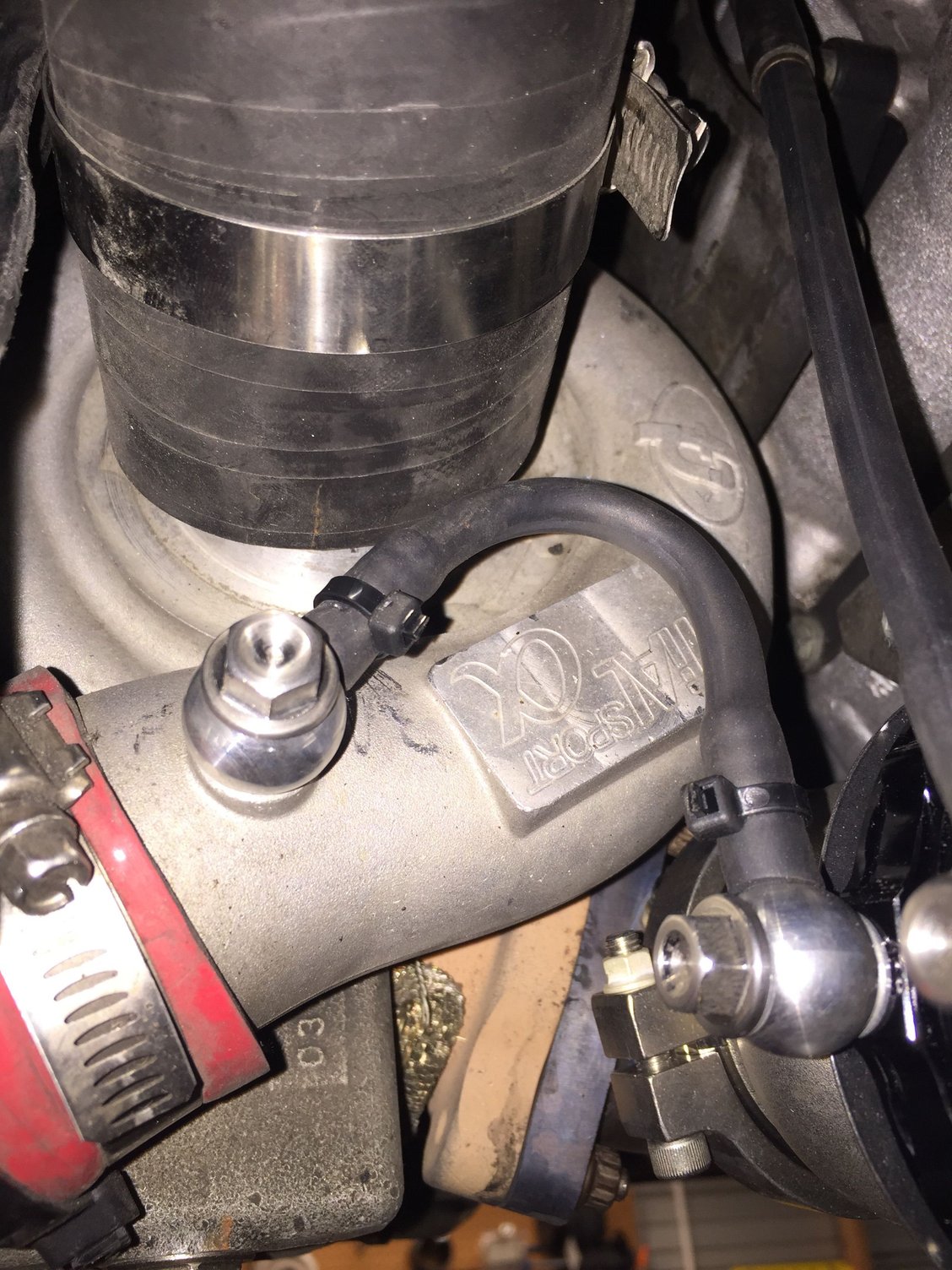

Here is the line from compressor to wastegate for me.
That's convenient, but my Garretts don't have those fittings. I picked up 2 spare large boost hoses that I can play around with installing the fittings I bought. The fittings are installed from the inside, has a backing plate to prevent it from coming out and the nut screws on the outside so no chance of anything falling off inside.
