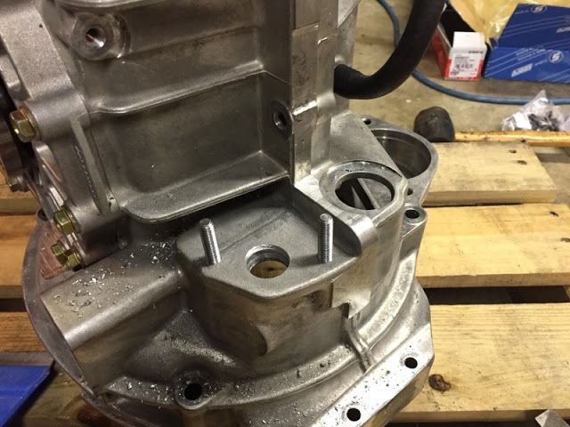

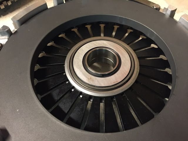

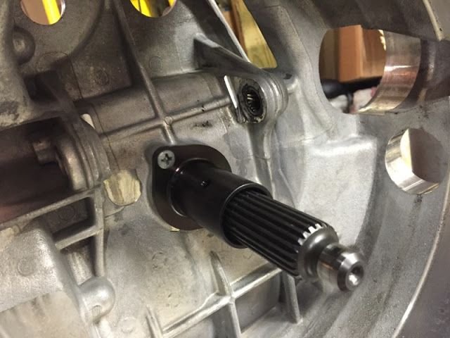

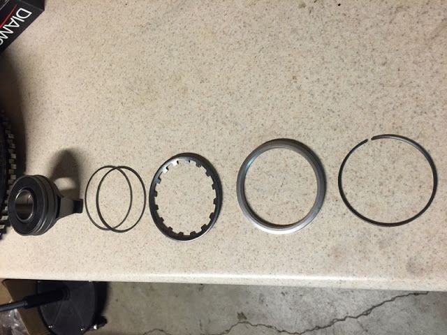

Bit of progress a few days ago. Assembled my throw out bearing.

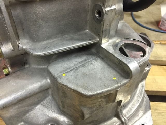

Mocked up my GT2 slave

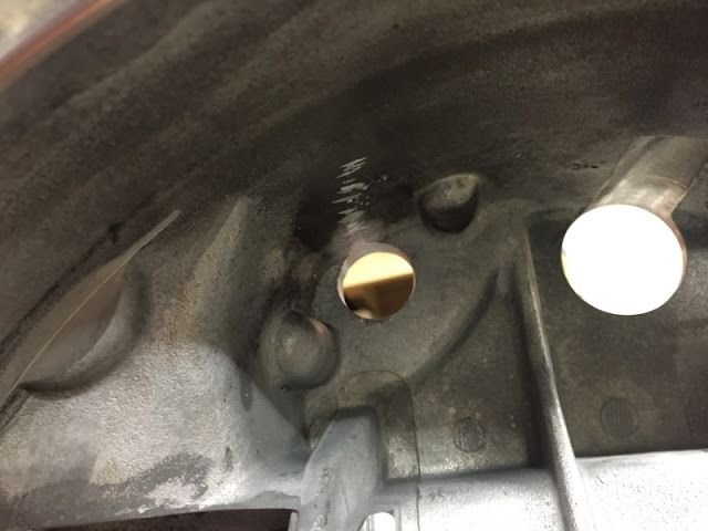

Paint pen dots. Center punch then drill and tap.
New studs turned in and ready to go.
You can also see I drilled out a larger center hole so the rod has some side to side abilities if needed. I used this hole type saw I had laying around handy.
The hole came through perfectly in reference to material thickness and where it should be.
After mocking up the new GT2 clutch fork (mirror image of the stock one) I saw it was catching on the bell housing area there a little. I took an air die grinder and cleared out a little material to fix that.
Stock throw out bearing sleeve on the left (or guide tube I've noticed Porsche calls it), GT longer version on the right.
New longer one installed
1 3/8" hole plug I found at my local Lowes. Closed off stock hole perfectly
Quite a massive differences in slave cylinders. Stock massive unit up front. GT2 down below. Could even be considered a weight reduction mod lol.

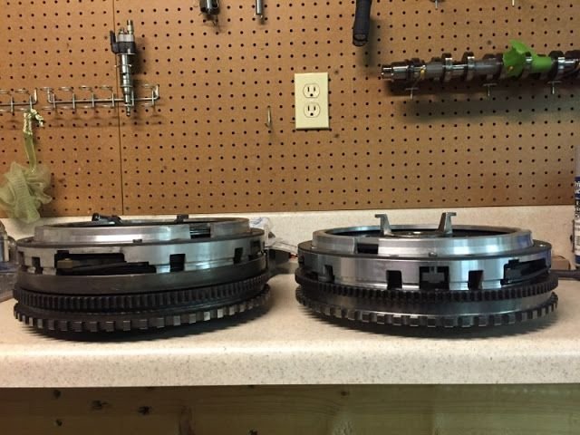

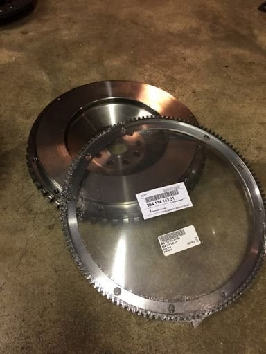

Stock DMFW on left and GT3 LWFW on right.
The weight difference felt huge so I weighed them. 20.2 lbs for the stock unit and 11 lbs for the LWFW. Not as big a difference as I was expecting just from picking them up but still pretty impressive.
Separate ring gear used on the GT3 setup. Pretty cool because that means you can remove it and turn this flywheel in the future unlike the stock unit.
See the difference in the stacks. Stock unit on left, new assembly on the right.
I have no idea if Porsche uses anything different than other brands so I picked up their recommended spline grease. I already have tubes of the stuff from Fords but knowing my luck it'll be something special for some unknown reason so I just got the Sachs stuff.
Then comes the living nightmare.....
Getting the rod in the side of that clutch fork after you re-install the transmission. Now in all fairness you guys warmed me it would suck. Boy did that suck to figure out.
So I taped it the way you see initially and then a bunch of other ways. Long story short is you can either tape that fork the correct height or the correct forward/back position but not both. It has to be away from the clutch and up a little. Basically hovering in midair in an impossible position.
I would struggle from the side with the bore scope trying to wiggle it with a screw driver. I'd get it lined up but then as soon as I pulled out the screw driver it would drop. I tried different combinations of electrical tape and painters tape. The idea been painters tape stretches as needed or the painters tape will snap and let go if needed. Transmission went in and out 7 times in this frustrating process. Yes you read that right 7 times. At that point I was running out of ideas so I called up a buddy and told him I think I need help.
So the two of us looked it over and came up with the idea of lifting the clutch fork from the starter motor hole instead of the driver's side or the hole up above there. So we got some wire and bent up a hook he could use while we watched with the bore scope. So that was #8 installation of the transmission. We struggled for ever and finally realized that was not working and gave up and pulled it for a different idea. We just couldn't get the wire to move the fork how we wanted.
#9 went in with our original tape setup from #1 and we took a new approach. I adjusted the fork from the driver's side with the screw driver as I had originally as I can get it in place in less than a minute. Then coming in from the passenger's side my buddy managed to get his fingers in somewhere and pinch the fork in place allowing me to pull out the screw driver and slide in the pivot fork. It would only go through the first hole but that was a major accomplishment. Then using the bore scope I could watch the second bushing and pivot fork right there while he managed to get his fingers in a hole over there and wiggle it up till the fork slid all the way in. SUCCESS.... shortly lived anyways lol.
I was so tired and frustrated at that point I took a socket extension to push in the bearing on the end of the pivot fork and it slipped out my hand boom I had a 6" socket extension laying inside the bell housing LOL. Oh my gosh I couldn't believe it.
However we had a process now. So for pulling the transmission for #10 and putting it back we knocked it out pretty fast.
That's quite literally where I stopped and haven't made it back to the garage.
Shouldn't be but another day in the garage and it should be done. I hope, dying to drive this car again.

you doing all the right things. if you wrap electrical tape down and under the c/f then when the trans is fractionally away from the engine you can lift the tape and ever so slightly raise the fork to line up the holes. btw this process takes about 10 minutes when the trans and engine are out and on a stand! now drill a 6mm hole in the black plug and assemble the plug and locking tab and bolt as 1 unit. use a rubber oring on the backside of the bolt to hold it in place and thread the 6mm bolt into the plug a few threads. now you can push it into place and use a 10mm socket to thread the bolt. this keeps anything from falling into the bell housing. keep a flexible magnet handy as well

great pics great to see the stock vs the other parts side by side and the step by steps are great. makes me feel a fool for not having done all upgraded sh8t too.
clutch fork *only* took three attempts here
carry on you're almost there!

Yeah I'll be looking into dropping the entire engine and transmission next time. Sounds so much easier to do just about anything on the car.
I forgot to put in the previous post the black plastic plug, retaining bracket and bolt are in already too. I did those right away as I was afraid the pivot fork bearing would fall out or something like that. I slipped the black plastic plug in with my finger tips holding it securely. The bolt I taped to my socket with some painters tape to avoid a mishap and the bracket I slid up with a small dab of grease so it stuck to the bolt and then just slid the assembly up there and threaded the bolt and snugged right away.
BTW I'm not sure how you do the electrical tape trick sticking out and then pull to line up. That was one method I tried a few times but couldn't get it to work.
its tricky but can be done. what i ended up doing which works slicker than snot is i had a tool and die shop use a diamond bit and drilled a 4mm hole in the pocket of the clutch fork. use the tape to steady it then when the trans is slide in i used a threaded 4mm rod and stuck it thru the slave hole! this allowed me to lift the fork with 1 hand and slide the fork rod in with the other. be aware it took 2 bits to drill thru!! hardest metal i have ever seen!
That's a pretty good idea. If I do this again I will definitely consider something like this or similar or some sort of tool for the job now that I know what's involved and what has to be done.

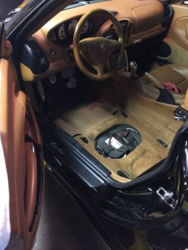

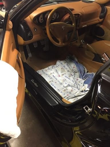

Some updates from a couple days ago. So as you can see I couldn't hardly get the door open with the car on a lift so I decided to remove the seat for access to under the dash.
It's just 4 bolts and super easy. You will need to hook the battery up to slide the seat either forward or backwards. Only two of the four bolts are ever exposed at any one time so you have to move it. One tip I read online says never connect the battery while the seat's electrical harness is unplugged or else it triggers an airbag light that can only be turned off at the Porsche dealer. Good to know.
Laid down an old comforter of my kids I keep for such jobs and I was in business. I highly recommend this to anyone working under the dash. Its unusually cramped and tiny under this dash been a small car in general.

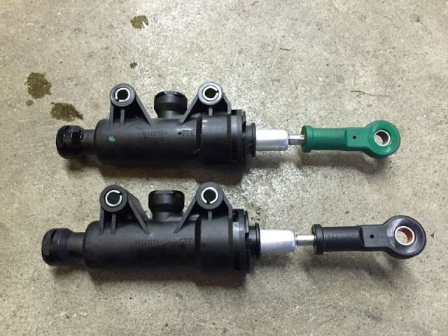

Got the master cylinder swapped out. Asides from the green color I could see no difference. I do wonder if I swapped out one part for an identical part. Anyways done. Stock is the top one with green.
Springs I could see a difference. Stock on the right, GT2 on the left.
I never read this anywhere but luckily I noticed it on the new spring. There's a cotter pin you can slide in the back through that rod to hold it in the collapsed position. Make sure you do this on the old one before attempting to remove or I imagine you'll have a heck of a time and possibly even pinch a finger real good as that thing comes apart.
Old clutch reservoir cap setup on the right and new DOT 4 cap on the left. Nice touch I thought.
I flushed 4 reservoirs full of fluid through the system to get the old Pentosin out. 2 more reservoirs full bleeding the system once the slave was hooked up.

The new clutch setup. Well the single mass light weight flywheel was a HUGE mistake. Very sorry I went that route. The car rattles at idle something terrible. I absolutely hate it. Its so loud inside and outside the car the radio doesn't even drown out the sound. Not that I use the radio but I tried it just to see. Sitting at a red light I have people next to me looking over at the noise. One guy asked me what's wrong with my car
It physically drives fine and the clutch engages nice and smooth and doesn't slip anymore which is a huge bonus. Unfortunately I just have to many other things going on right now to redo this clutch or I'd have a DMFW on order immediately. I guess winter project when things slow down.
Oh and I might add I notice no difference what so ever in responsiveness to the engine from the flywheel change so it seems like a complete waste having that rattle. Maybe the car was down to long and I just forgot how it drove but it sure seems the same to me.

Something is not right. That is waaaaay loud in the video. What clutch disc are you using? With the 764PP and GT3 4.0 disc and 964RS LWFW my car makes barely any additional noise, only when in neutral with the clutch released and when the gearbox temp is very hot and then it's barely audible only with the windows up and radio off. My clutch also engages perfectly in the middle. I run Porsche fill Delvac 75w90, try that over the redline to see if that makes a difference.

Hmmm...is it possible that your single mass flywheel is not an actual Porsche part and that it is an aftermarket Atsco or something?
OK that is a huge difference and how you describe the noise is what I was hoping for. I wonder if the transmission oil makes all that difference? I have the RedLine 75w90 that's recommended on Pelican Parts website.
I'm pretty sure I got all the right parts.
This is the exact clutch disk I used.
997-116-013-91-M38
This single mass flywheel
964-102-239-31-M894
With this ring gear
964-114-143-31-M260
All three of those were purchased at pelicanparts.com if you want to look at their descriptions etc.
The pressure plate I had gotten in a "kit" from AWE who refused to take parts back so I used it. All he would tell me as far as part number is 764. I "assume" that's 88-3082-999-764. He would not elaborate further.
I will definitely give the Delvac a try. If that makes it as quite as you describe I'd be so tickled and happy lol.
