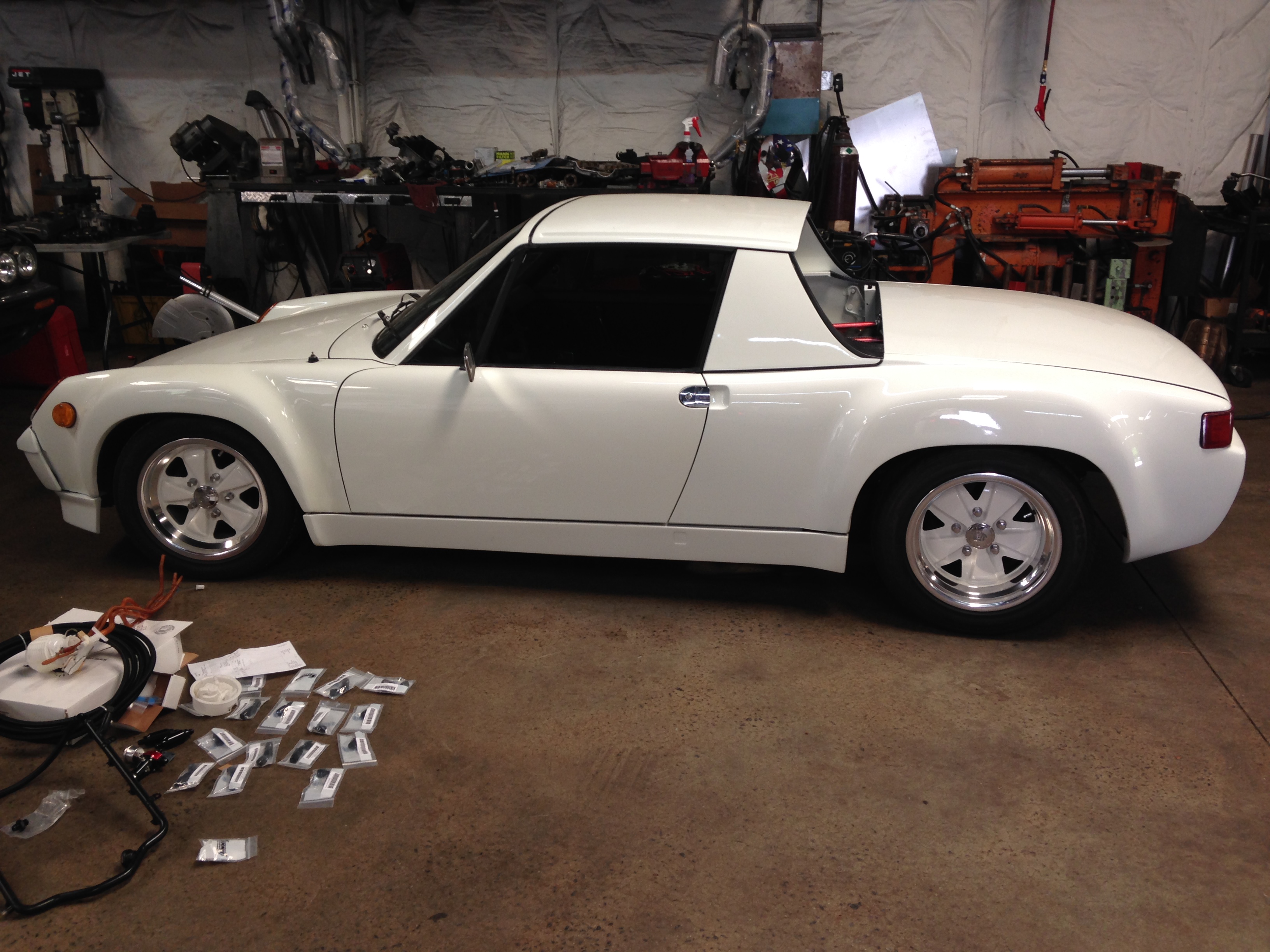

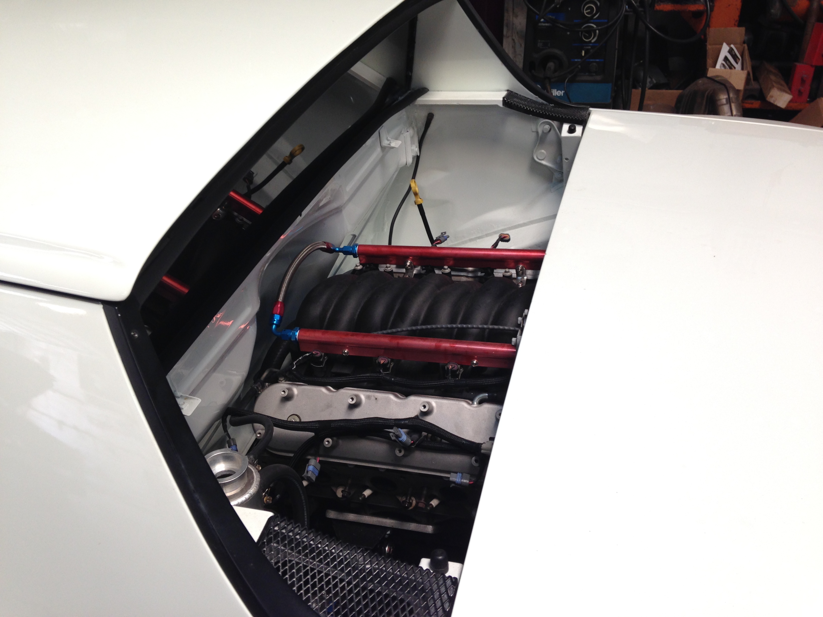

32krazy!'s Avatar
Joined: Dec 2008
Posts: 5,551
From: tn
Rep Power: 628
Originally Posted by VGLNTE1
Could just spend 7k and do a complete built Ls motor and swap that in. Lol.
the shop i use in atl has a wide body 914 with a 383 stroker motor in it. GET YOU SOME OF THAT!!

Looks like a Porsche El Camino LMAO.....
