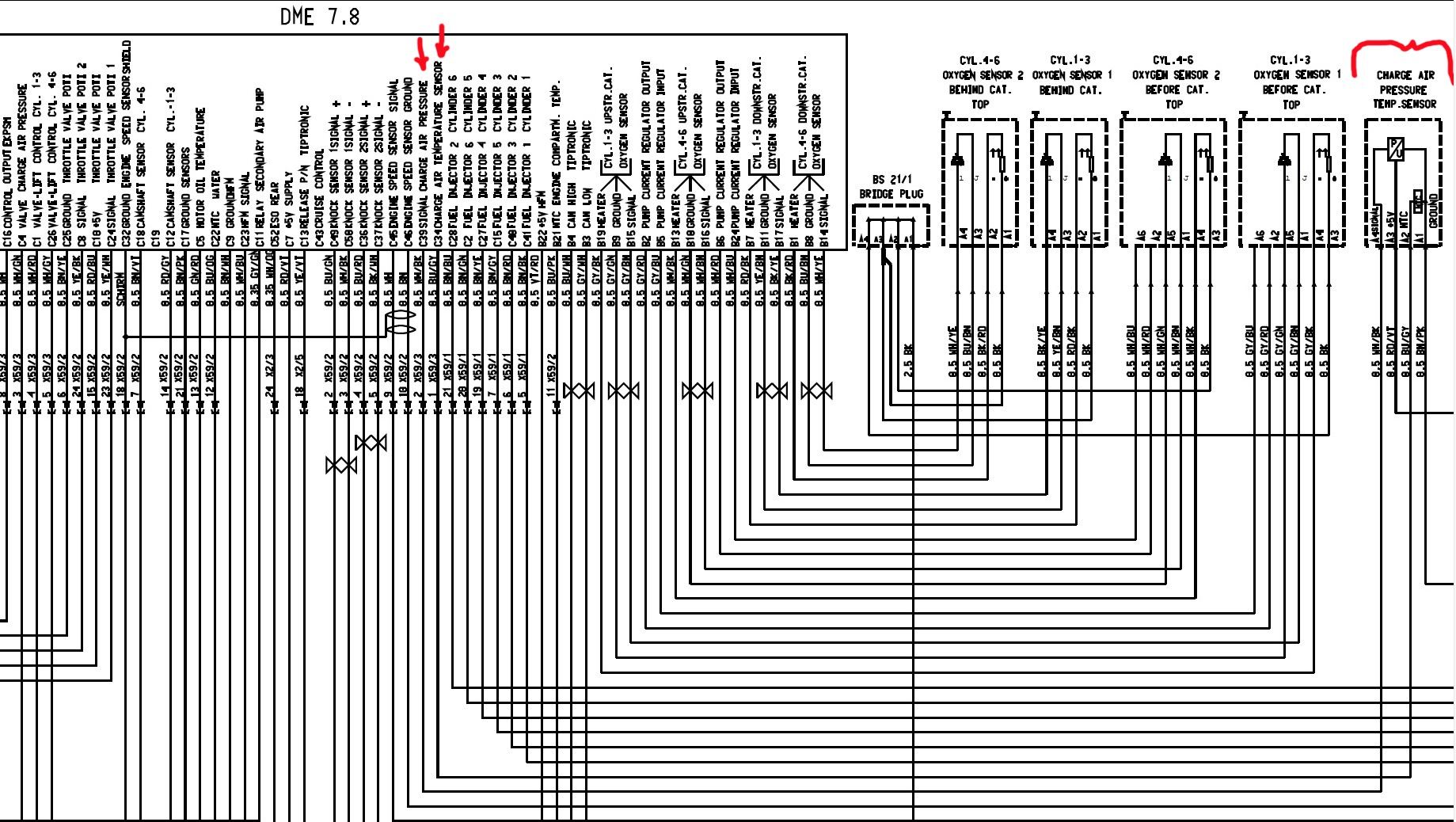

From the sensor (pressure/temp) to the DME (ECU) it is dedicated wiring....But from the DME to the instrument cluster it should be part of the can drive bus....
Name:	Screen Shot 2015-06-01 at 21.47.36.jpeg

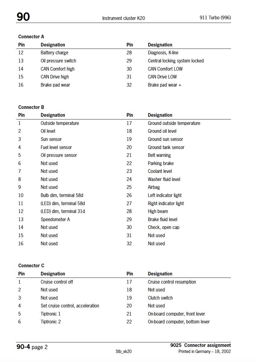

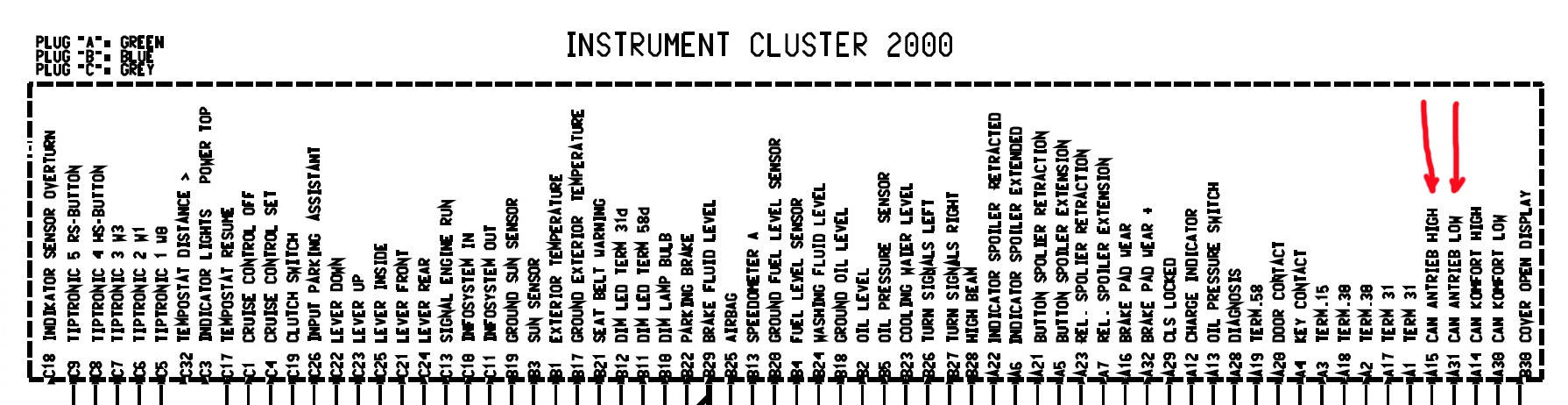

Here are the cluster connections:
Name:	Screen Shot 2015-06-02 at 08.08.40.jpeg
ID:	421380   Click image for larger version
Name:	Screen Shot 2015-06-02 at 08.08.50.jpeg

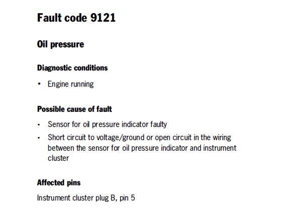

In fact oil pressure transmitter is connected directly to the instrument cluster: Look at the troubleshooting if you got the code 9121: Plug B pin 5...
Thanks Jp. That confirms it.
