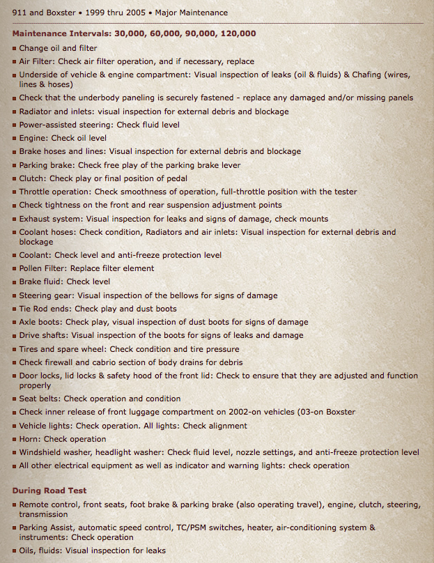

RennTech.org link:
http://www.renntech.org/forums/tutor...ions-pictures/
also attached Porsche's service intervals...basically, plugs every 4 years or 40K on 2005 Turbos.
Also, checklist for Major interval which really is when you do plugs and coils.
Good Luck, it's not hard
File Type: pdf
