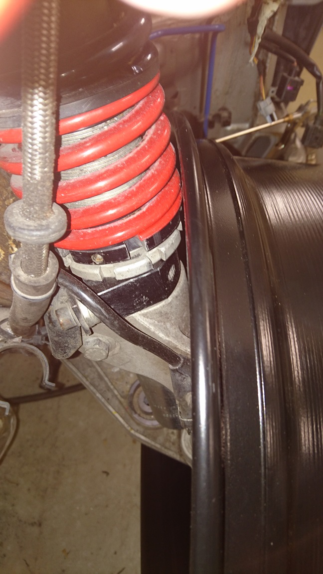

Here's how 10x18 et37 & 11x18 et5 look like on a narrowbodied RWD, ie I need some flares...
Wheel to spring clearance at front is about 1.8 mm:
Rear:
Name:	Wide rear1.jpg
ID:	467116   Click image for larger version
Name:	Wide rear2.jpg
ID:	467117   Click image for larger version
Name:	Wide front1.jpg
