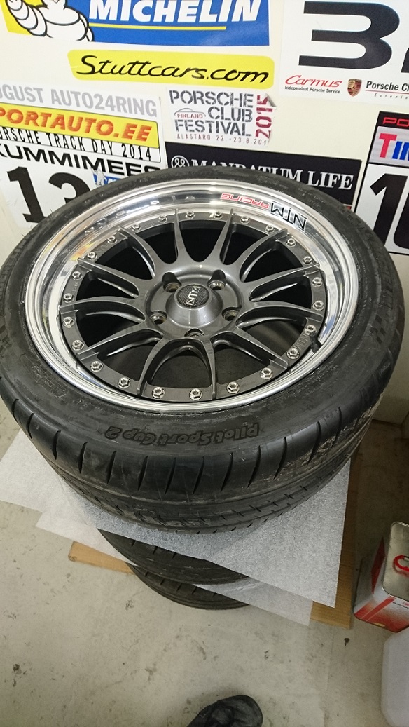

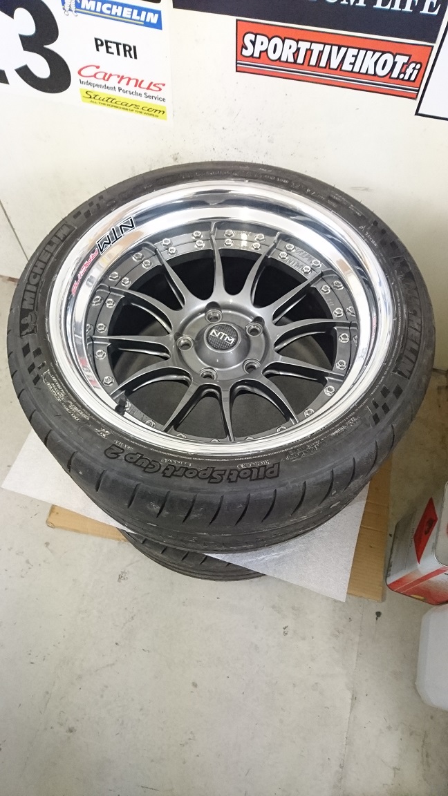

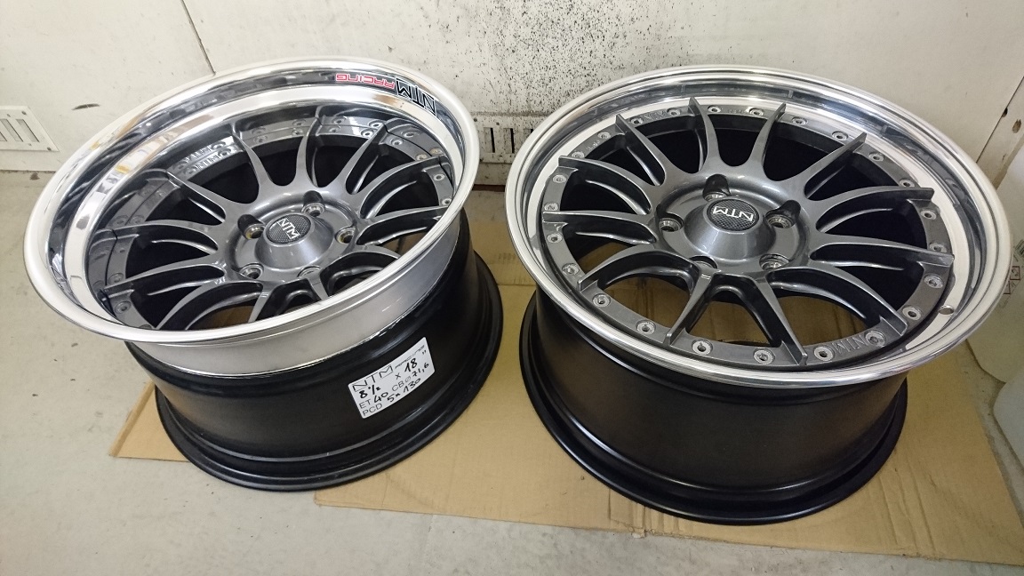

Fadi, here's pics of those rims (as per your request):
ID:	467616   Click image for larger version
ID:	467617   Click image for larger version

Thanks Pete looking great, guess my rims going to have a bit bigger dish, but still dont know which color to go for ))) anyway your color combo looks tempting to me

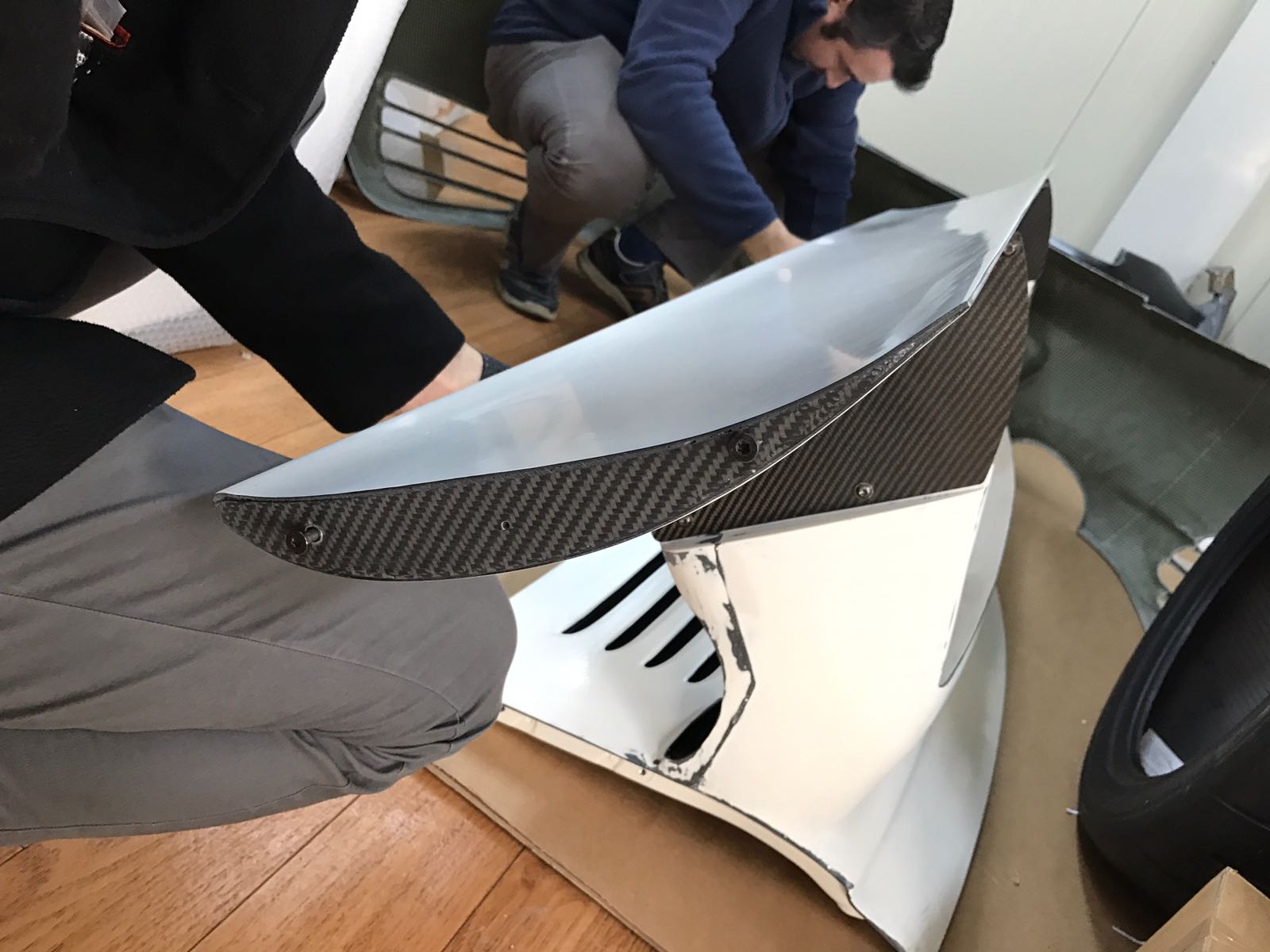

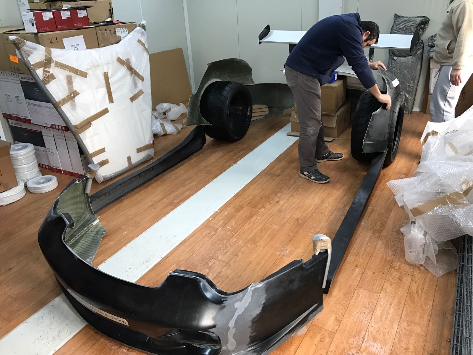

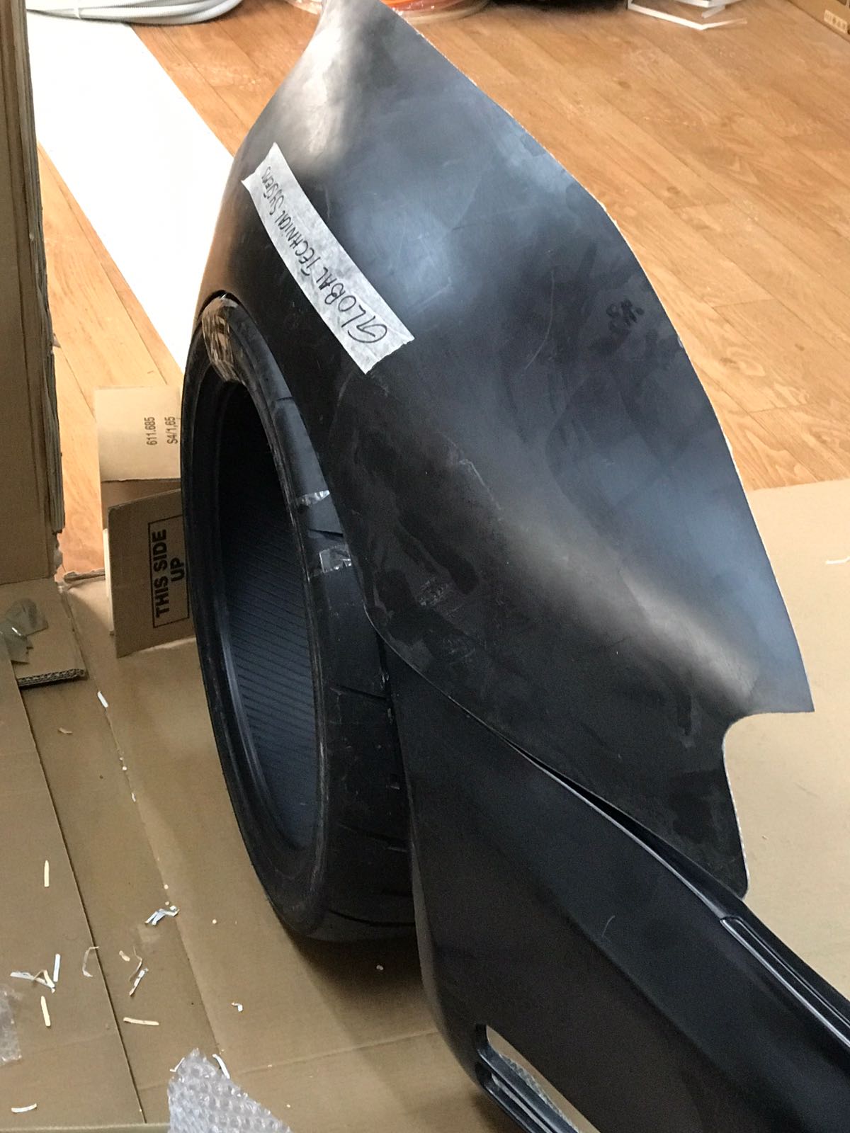

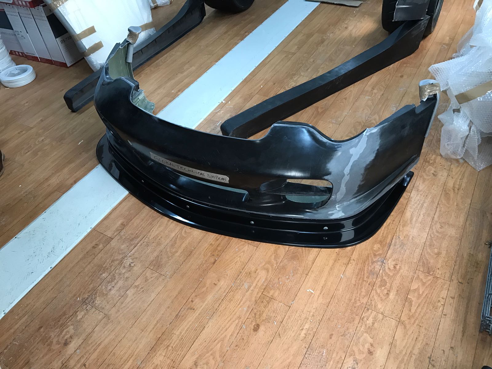

body kit
Body kit finally arrived this morning, they used a box form a Moto Guzzi bike to deliver
Will try to install them ASAP and make final calculations for ordering custom rims in terms of ETs, I guess we might be able to fit 300 wide tires in the front, not sure about the rolling diameter.
All parts are carbon or carbon+FRP mix, in the end we hope to get off from the total weight of the car up to 100Kg(220lbs) including A/C removal, Stereo, interior, one race seat only etc and get bellow 1400Kg if possible, car stands now at like 1500Kg full tank.
Considering to bump up power a bit at least in 4th gear and above 5500rpms or so in 3rd gear (can do boost by gear), maybe 1.6-1.7bar... That will give another 100hp for straights mainly.
Just bought for testing 275/335 R888 and having some 245/305 19" with Cup2s also for initial tests, later on will order some slicks, after we determine the biggest front tire able to fit, if a 650-660 tall tire will fit, will have plenty of possibilities
