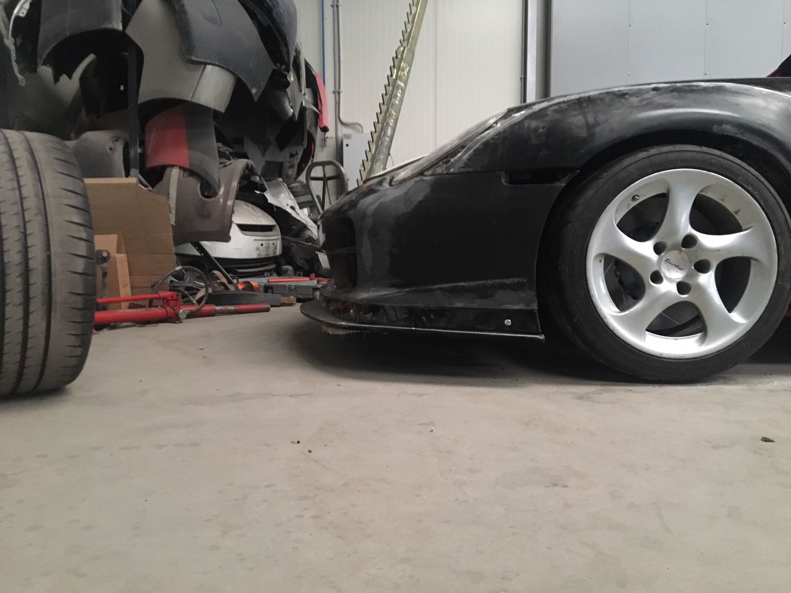

Really happy, managed to fit easily 265/35-R19 in front, they are going to make a perfect pair even AWD with 305/35-R19 rears, tires are MPSC2
The 660 tall slick tire works also, with a bit of effort perhaps being able to fit 670-680 tall tire, even might hit the fender at the top of the tire, still not sure about that.

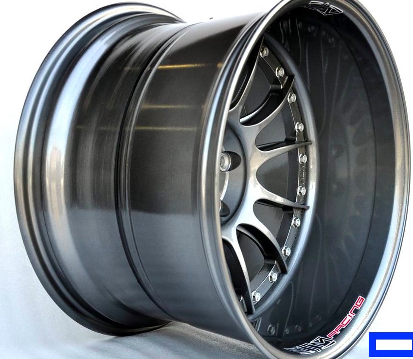

In the meantime I have made final? estimations for the rims, they will be matte gold and polished lip
10.25J ET24
13J ET-5

Amazing stuff John, really pushing the limits of these cars by finding always new ways to improve...good tips ! Maybe if we get some interest of few guys here can do a group order to your fabricator, I would be interested even using the flares and wide front bumper I was able to push forward the front radiators by a LOT, also modified the their mounting brackets and now can easily run a 660mm (26.0") tall front tire, so the 0.9" difference wont be such a big problem as before. With some further modifications might also git a 680 tire in the front, but for sure can not run too lowered if so, still might hit the upper side of the fender, not sure can fit
As an update to my build, we picked the rims color (thanks Pete), should be gloss gun metallic even the producer says matte might be better, we have some glossy elements - carbon, black and guess glossy would be better..
Final specs are 10ET27 and 13ET05, we kept a very conservative setup as still lots of variables
Pics
- Hankook slick 280/660-18 (306mm wide) gets out of the flares but can see how it fits
- Rims model from a drift car, just to have an idea
