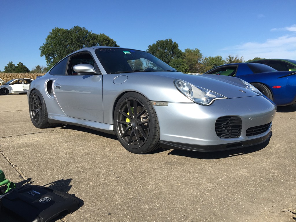

Originally Posted by vogz
I run a very flush setup and I have zero rock chip issues. They shape of the 911's doors and side sills are completely different than a BMW.
Attachment 483218
What size wheel, offset and tyre size are you running with the B8s and H&R springs? I'm going down this route and looking at 19x12 rear, ET51 with 19x8.5 fronts, ET53.
Anyone know if they'll fit ok and if I'll definitely need adjustable rear toe arms?
I'm running 19x8.5 ET52 fronts with 245/35-19 Pilot Super Sports, and 19x11 ET42 rears with 305/30-19 Pilot Super Sports. Also run a 5mm spacer in the rear to keep the inside rear from rubbing on the wheel liner that covers the turbo inlet. I had to roll my rear fenders to keep the rears from rubbing over large bumps.
It's a tight fit but totally doable.
The 19x12 ET51 wheels you are looking at won't work unless you use a 15ish MM spacer. Really no reason for a 12in wide wheel in the rear anyway as you can run 315s easily on an 11 inch wide wheel. My 305s are even stretched a bit on the 11inch.
Thanks for info. I want the 997 GT3 wheels with the rear dish though, I believe they're 19x12.
ah, will be a tight fit. Might be able to pull it off depending on tire and spacer setup.
