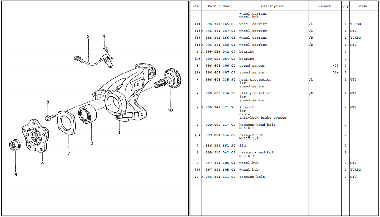

Below is a picture of some 996 and 996 lower control arms. Not sure what version, but you can see the 997 versions are not longer than the 996 version. The 996 versions have RF and LF written on them. My guess is the wheel carrier is different.
Later, Steve

The wheel carriers are def different. But I don't think that the track width difference is in the carriers.
Pwdrhound might be able to add some insight here. He's running 997 hubs, maybe he's looked at the carriers as well.
There is also a guy running a wild pushrod suspension on a 996. He is planning on swapping to 2010> 7GT2/3RS front uprights. The conversion is being done at bbi. Might give them a call and see what I can find out.
I am going to guess that the difference is in the subframes (which are different too).

Subframes and wheel carriers are different on the 996 and 997. Hubs are the same. Frankly I never looked at the difference in the rear track width, didn't even know there was one. I'm assuming the 997 is a little wider then?
