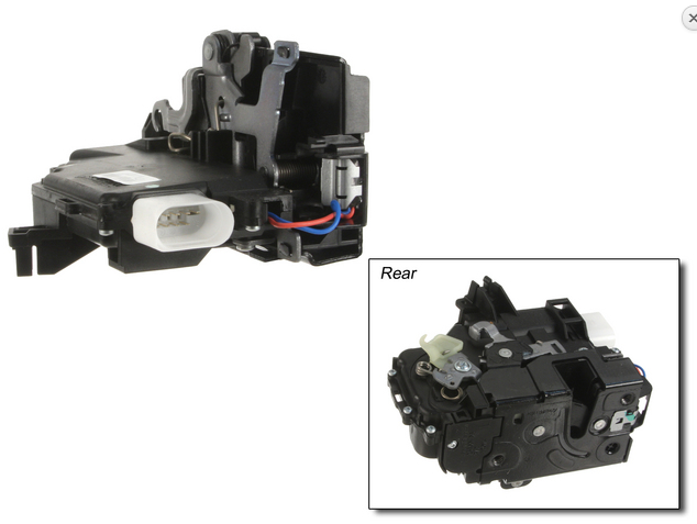

I'm more confused now, I had to take off the other door panel to replace the broken pull spring so i swapped the micro switch on the inside handle with the one from the broken side and they both worked on the driver side and neither worked on the passenger side. Is there another one in the latch catch mechanism?

Ok did a little more work, pulled of the latch mechanism and found out why it goes bad causing this issue. There is another micro switch on the latch that works on a cam. Its weird but it's a plastic cam and both the plunger and the cam are wore down so when the door closes it doesn't move the switch. New latch it is.

There are multiple micro-switches inside the latch mechanism. It's really not that hard to get it out and replace the whole thing. Replacing a micro-switch is more complicated. A 10-minute job if you are careful.
It looks like this:

So there is actually 3 of them, 1 behind the inside door pull, 1 on a harness that goes from the latch mechanism to the latch and one that is built into the door latch itself. Not to bad to get to.
