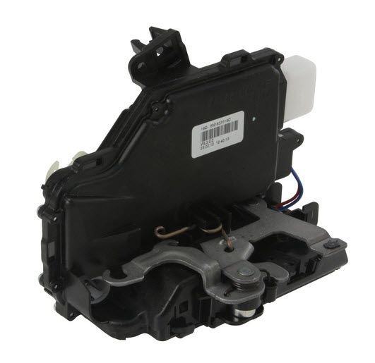

I don't think it is as hard to determine the source of the problem as some seem to suggest... If the window moves at all when you lift the latch, the micro-switch is fine. If it moves but doesn't move the correct amount, it is the regulator.
Edit: P.S. There are NO micro-switches in the door handle! They are all in the door lock mechanism:
mine would drop slightly or not at all. i replaced the regulator and the problem persisted. removed the microswitch and replaced it and the issue was fixed.
if you look at #14 in the diagram i posted theres a door window microswitch in the door handle assembly

I've had to fix both parts, I don't remember ever having to disconnect a wire to remove the door handle (... my brain could be failing though - sometime I do these things without noticing). There is a linkage (#12) that connects the door handle to the door lock assembly that activates a micro-switch in the door lock assembly. When my window didn't drop, it was a micro-switch in that assembly that had failed.
that's not entirely so. the improper up/down motion of the window can indeed be attributed to the door latch mechanism, which has been correctly pointed out as one of two probable sources of his issue!
were that not so? then my replacing a door latch to restore the proper opening upon activating the handle would never have been possible. again, that's why i mentioned many of the symptoms overlap. in my experience, of course. YMMV.
