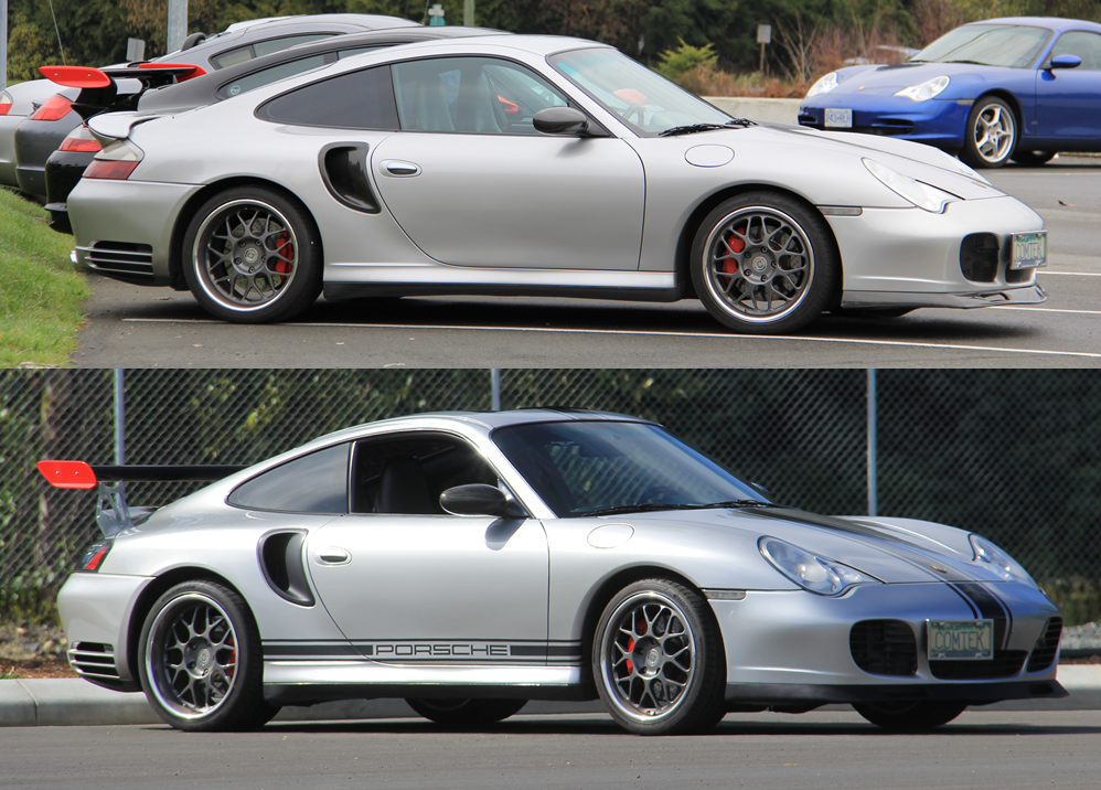

Here is my before & after comparison...
The wing in the before picture is on the car behind mine.
