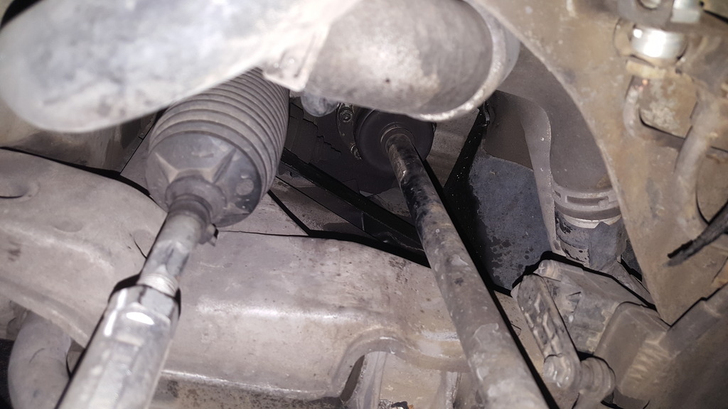

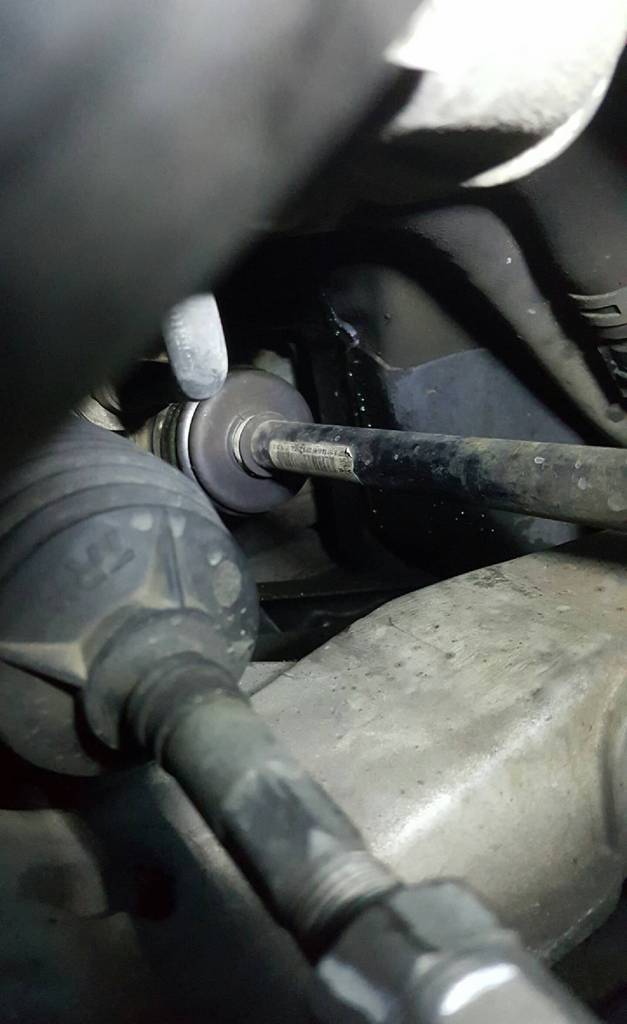

Well took the car to C&C this morning - saw a few members there and was a great turnout. On the way home was getting a serious whine up front so I pulled the front wheels off to peak around and noticed serious leak from the front diff. Going to the shop tomorrow but my first reaction is to to RWD sooner than expected and will begin the hunt for an LSD. This car is 98% track although I will drive it to and from...open to any comments.

Turns out passenger axle busted not the diff - not sure where the whine is coming from but will continue to scour parts for LSD and RWD
