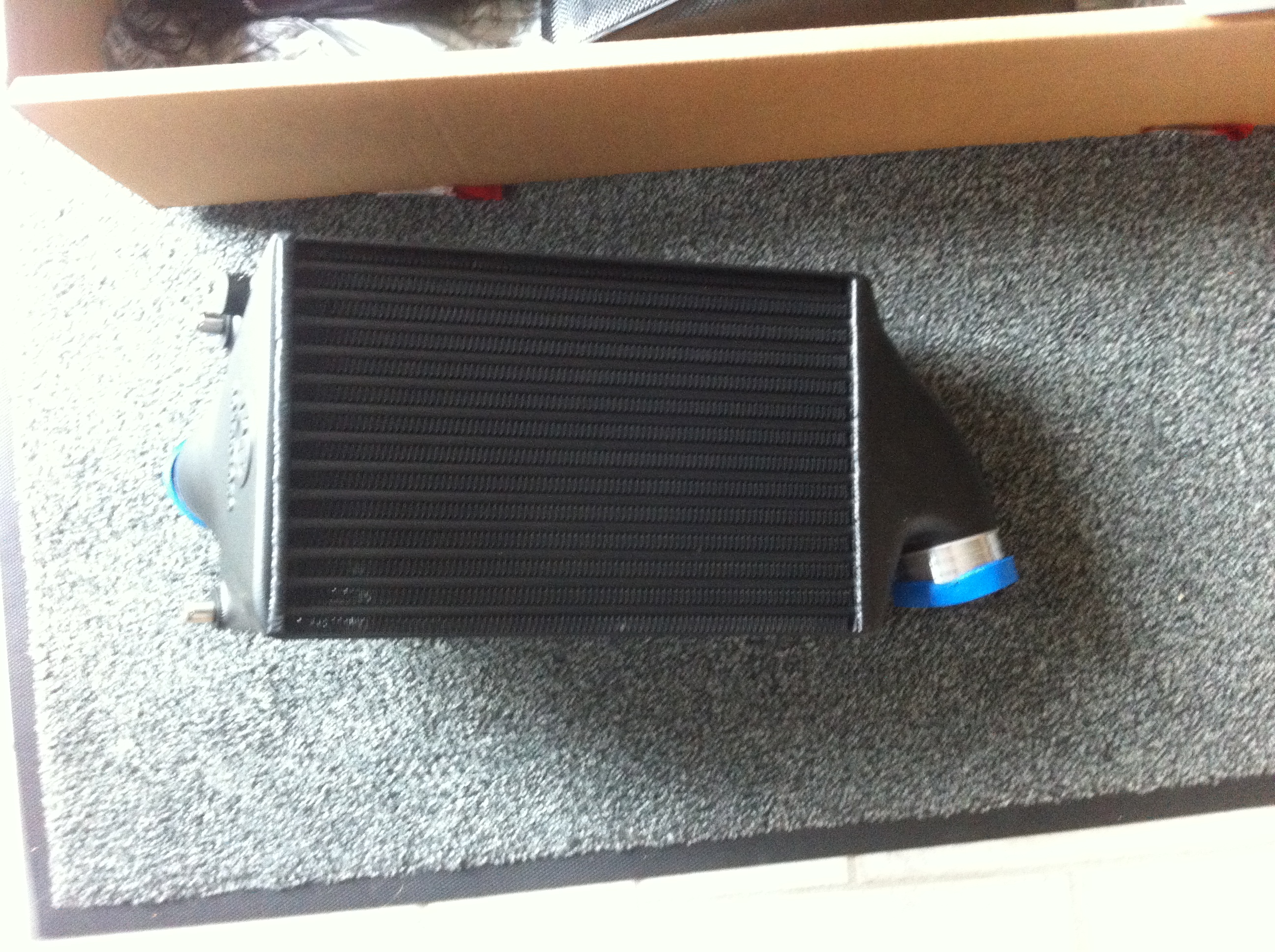

wagners:
what i am seeing is, its 2 intercoolers in one...... flow is twice as one and cooling is more than one
inside there are fins too...

They didn't just slap it together. Everything was accounted for and calculated including air flow through the core inside and out, fit as a complete kit, application (remember they make 3.5's as well) HP level and finally cost. The picture does help thanks Win. You can see the carpet through the core
This is years in the making. I remember speaking with them about it at SEMA 2014 and it was already in development. Work with an experienced seller/tuner you trust and you should be fine. I apply these to many builds with confidence and go over the logs with my clients. More and more will be posting soon.

These are an interesting design as it appears to be a tube/fin core versus a bar/plate. But it's super thick too so can still sort of act like a heat sink. IMO I don't care at all for tube/fin cores and believe the bar/plate to be superior but that's not to say these won't or don't work well.

Got this from one of my guys. It's literally almost like two of the RS Cores stacked!
