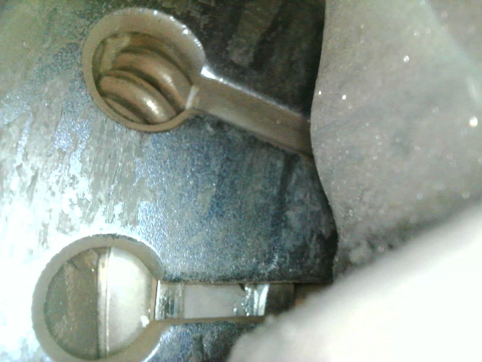

It sounds to me like your release bearing broke apart (been there). If that is the case, trans has to come out, but there would be no issues with your hydraulics. Don't rebuild your slave if you don't have to.

Yeah I agree that likely the bearing or pressure plate has went south to some degree. I already rebuilt the salve cylinder and replaced the accumulator so I'll just chalk that up to preventative maintenance and not cry about it too much. I don't think doing this on my back would be the best so going to stop at a local shop tomorrow and chat about it with them. Working on a clutch upgrade now.

Well I played with my $27 endoscope some more. I see one of the rings that I believe is part of the release bearing broken and pushing on the pressure plate "finger".
Problem (bottom right of pic)
Sprung hub disk
