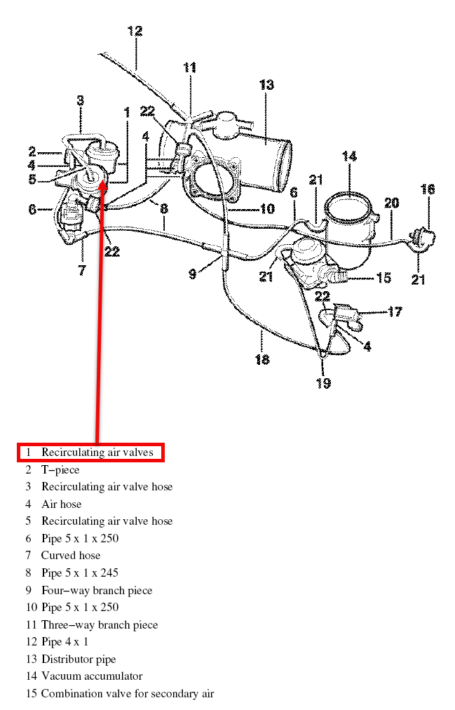

I have conducted a leak test and I'm hearing air leaking around these valves - I have removed the F Hose and it was in great shape, so the only thing that could be leaking around there is one of these valves. Has this happened to anyone? If there anything else in that area that could be the source of the leak? When the car is running, I can still get 0.6 bar. I have a tune, I should get 1.0. During the test, it won't hold 1 PSI.

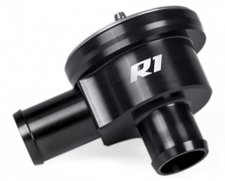

I guess I answereed this myself... These are refered to as "Diverter Valves" by the community here. It is common for the OEM parts to fail. I have ordered some new APR diverter valves because they maintain a diaphram technology instead of opting for the "piston" type which are more suceptible to lubrication failure. I just have a tune, so I am not pushing a lot more than stock boost.

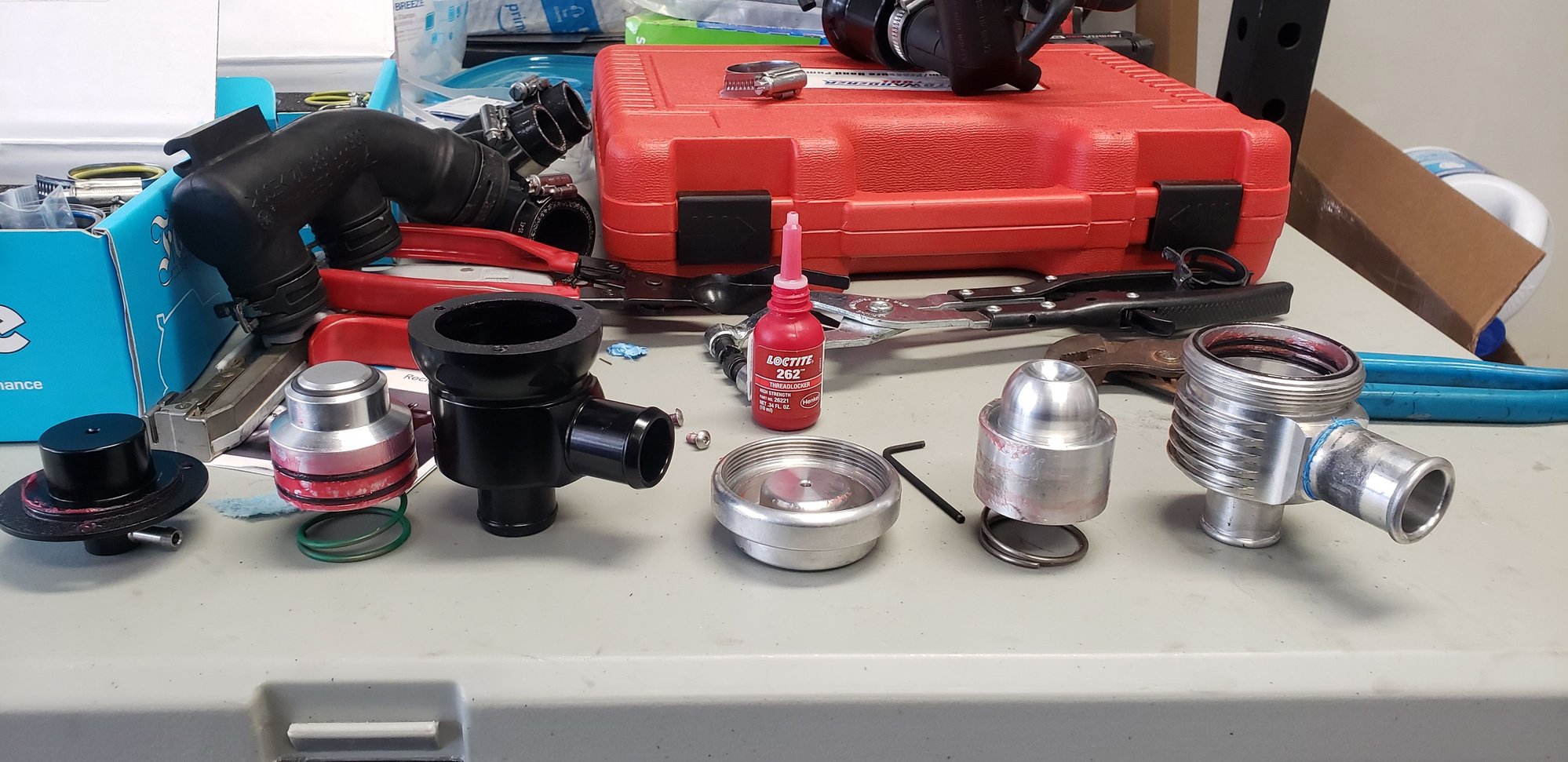

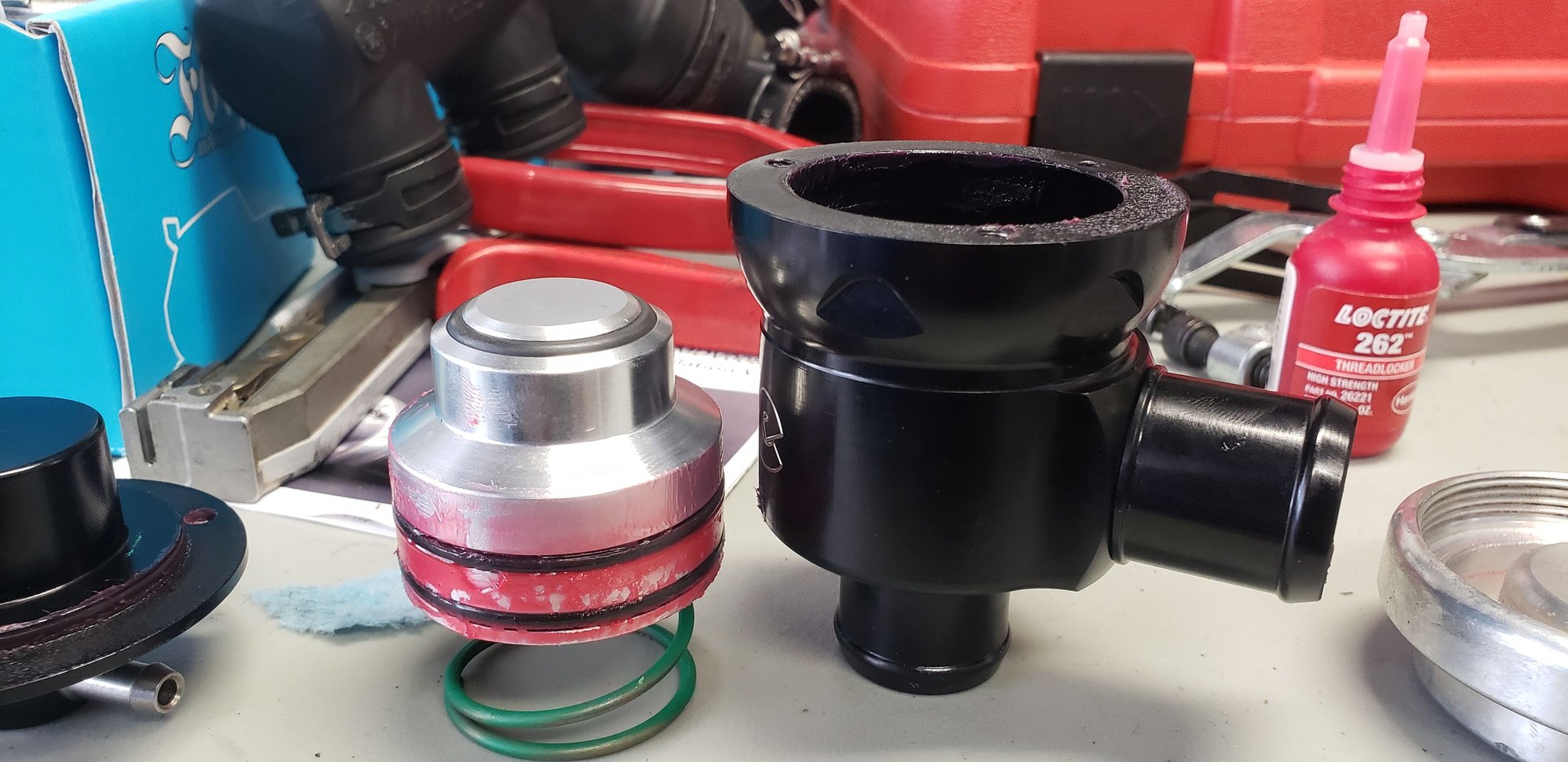

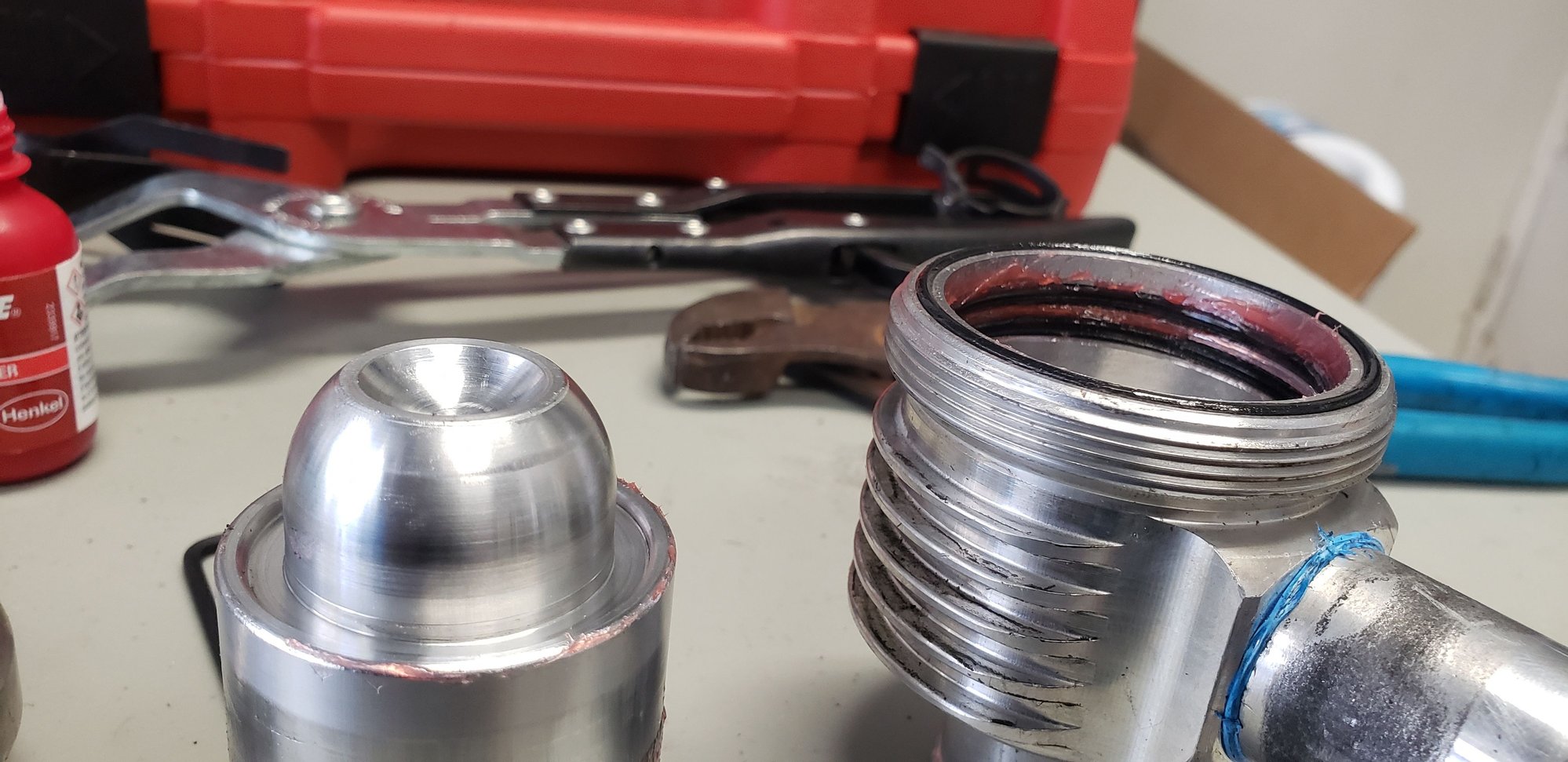

I just replaced mine from an unknown brand billet to a forge 008. You can see how they're both piston type but one has an oring to create the seal. Much happier with the new forge I got

Those look nice, but I'm just wondering how often you would have to remove them to re-lubricate...

From what I read the 710N made by karcher is not as reliable as the Bosch. And relubricating is 3 screws vs having to pull the whole assembly to replace. I'm happy with the build quality. I also tested the springs it came with, the green released at 10 psi and yellow (which I'm running) released at 20. I also just had turbos redone and working on the tune
