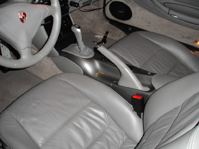

Getting rid of that green plastic definitely has to be good for a 50hp increase and at least 30lbs reduction. Add the additional 50hp from the recently installed Seal Grey center console from Eric at Bumperplugs.com....
I am building a monster car baby!!

Forgot to add the CC photo
