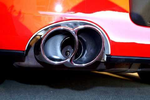

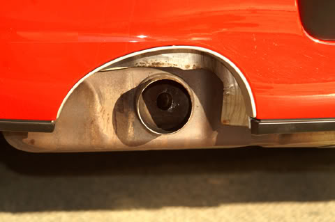

I did the mod today. It took about an hour, but I moved slowly. It was a little more difficult then I expected. The surface is very curved back inside. I used a center-punch to get a dipple. I started with a 1/4" pilot hole, then 1/2", and then 1 1/8". I was unable to use the larger unibit I have, as it is to long and would hit the next wall beyond the hole. So for now, I have a 1 1/8" hole symetrically placed on both sides. There is a significant difference in sound. I also believe the engine spools up a little quicker. To me the sound is enchanced, but not overly loud. I most likely will continue to 2", but for now I am impressed with the change. No CEL and so far no indication other than success, but I only did a ten mile canyon run so far. Thanks to everyone who paved the way for my mod. If you are near Malibu, and want to hear it in person, shout me out with a PM. Heres a couple pic, the angle is misleading, the holes are centered on the pipe. Tomorrow I get my flash codes!!yes!!

The airgun bits are not too deep...one does not get into the back of the pipe....BUT USING THEM IS LOUD. I let my mechanic do the work because I don't have the airgun and he is quite good z(so it cost me 2 hours of his time and a few bits...3 to be precise).... One "could" do it oneself with the right tools.
I hope you enjoy it. As Wooosh showed, one gets HP and torque.
If others do this, please post similar stories and locations....it will be helpful to others to have a "local" with the mod to hear. I sure would have liked the local sound check...
Now at over 2 weeks and no CEL. My car nut friends have all noticed and like the lower sound more. 2+" does give more grow and may not be to all tastes....no "drone" but also not silent....it is almost a muffler bypass at that point I suspect.
http://s182.photobucket.com/albums/x...urrent=ex3.jpg
http://s182.photobucket.com/albums/x...urrent=ex4.jpg
