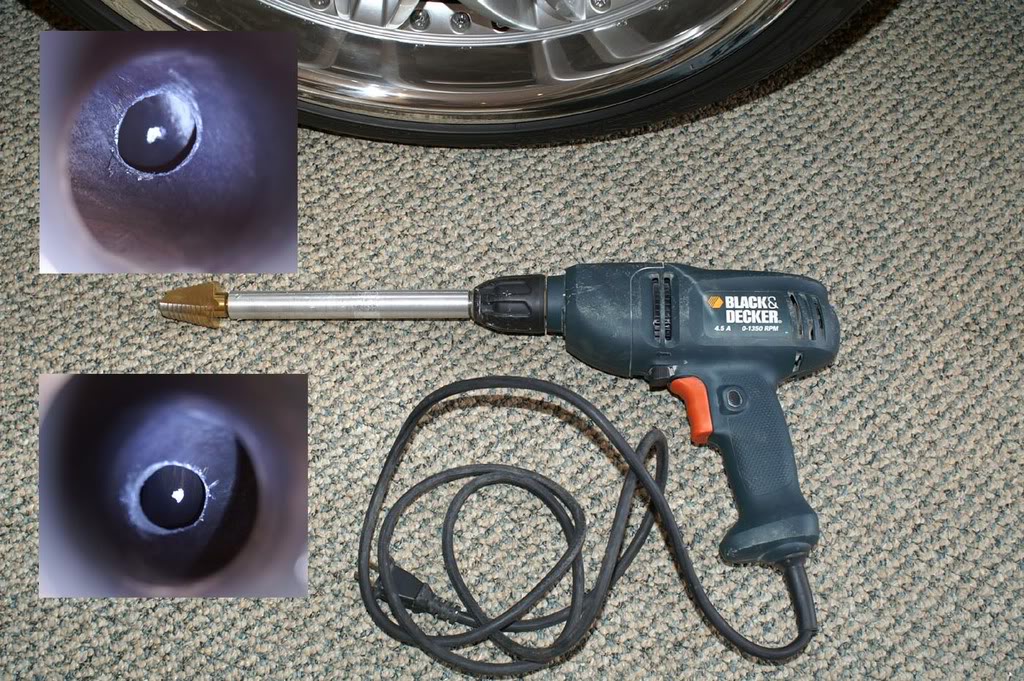

I performed the mod this last weekend on my car using an 18v DeWalt drill, a #9 unibit, and a 12" extension.
It took about 30 seconds/side to do. Very easy, and I didn't even have remove the exhaust tips.
The car does sound a bit better and it surely didn't slow down after the mod. It may be my imagination, but I do believe it is boosting more now than it did before. I'm seeing .9 and 1.0 bar in second and third now.
For those on the fence, go for it!

Update on the muffler bypass I did last month. I went from 1" holes to close to 2" holes today. No problems, i.e. CEL, etc. It's a tad bit louder, and a bit deeper with the bigger holes. I'm glad I did it, and it feels a little quicker.

Nice to know you can do it without the fancy airgun mode...a lot cheaper too I am sure. :-)
I have grown absolutely used to mine....in no way is my 2.25" or so hole set a bother....see my thread pictures way back at post about 30 or so.....in this thread. Basically, if my mechanic could see it he removed it. So, it is basically a muffler bypass. The cats and turbo muffle the sound a lot.
The fact the one guy had it on his car from the prior owner for a few years....makes me feel quite good. He reported no issues at all.
